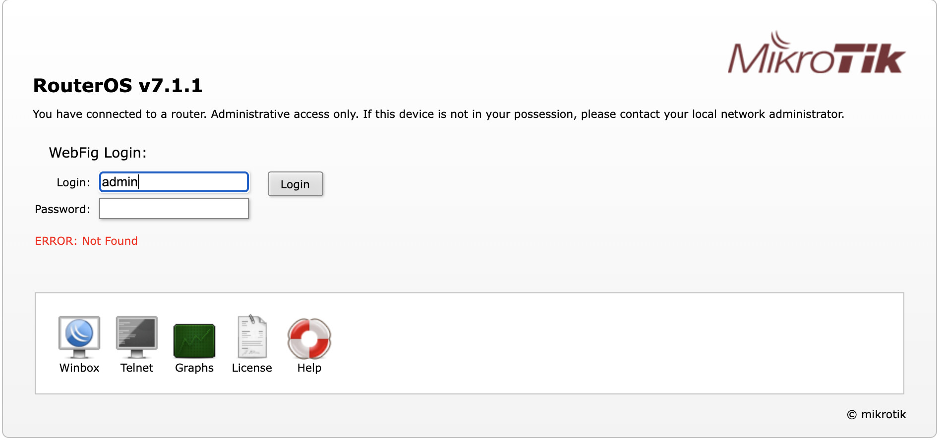

7.1.1 all around. Webfig:
RB4011iGS+:
  1. missing Wireguard configuration options completely (both in the main menu and the the interfaces-> add new)
  2. IP->Routes shows nothing (CLI shows routes)
  3. Routing->OSPF shows nothing (CLI shows config and routes)
  4. Cannot add graphs to status page
  5. Graphs accessible over HTTP but not HTTPS (Error 404: Not Found)
mAP L-2nDL: similarly affected.
(1), (2) and (3) seem to be OK on a wAP R-2nD
B.
Update: Points (1), (2) and (3) seem to be browser and HTTPS related. With Chrome 96.0.4664.110 (Official Build) (x86_64), connecting to “https://router_name/#Status” is not possible (webfig reports a red “Error not found” shown in fig1). Using HTTP, or HTTPS with IP address or FQDN works as expected. Firefox 95.0.2 (64-bit) does not seem to mind either way

Same issue here. Chrome + v7.1.1 shows “Error not found” on login. Safari and firefox works.
This ridiculous login bug also happens in ROS 7.4.1
