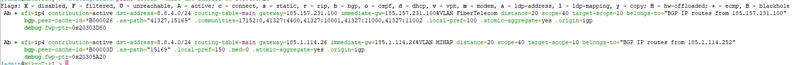

After investigating I verified that I receive the routes from Google and they have a local-pref of 150 but the routes coming from my transit are still active even though they have a lower local-pref.
You can see a screenshot of the routes:
As you can see they both of them are active and marked with ECMP despite the second one having a higher local-pref and a shorter as-path.
I’ve also tried setting a higher weight for the routes coming from the IXP but there’s no difference.
The only way that I was able to select the second route without filtering the first is setting a lower distance on the routes coming from the IXP.
Am I forgetting something or is there something wrong?

The problem here is not that the route is installed but rather that is being marked as active and not as a candidate.
I have other routes that are being announced both on the transit and at the IXP and the local-pref is working as intended, the routes with a lower local-pref are being marked as candidates and the ones with a higher local-pref are being marked as active.
