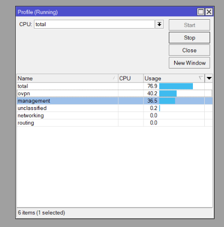

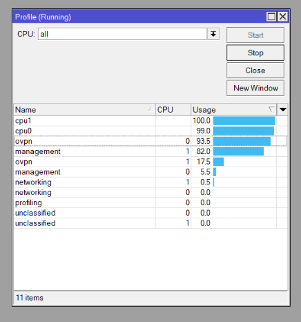

it happened again
at the very moment, i took 2 screenshots from tools>profile to see what service is causing this
any idea?
It’s ovpn and winbox… How many ovpn session you have?

It’s the OVPN, it’s having problems in version 7.8, there are already several reports from users about it. It even happens to me and in a few minutes the router restarts. I had to go back to 7.7.
