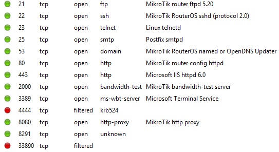

After that, i did a portscan from the outside to this device:
Port 3389,8291 and 443 were open before - rest was closed.
We will exchange this device with a freshly installed and afterwards have a close look on it.

Did you had ports port 21, 22, 23 and 80 disabled from “/ip service”, or just from the outside using an “/ip firewall filter” rule? In fact, are you sure you had them disabled (as they are enabled by default)?
If you only disabled them from the outside, it’s possible that there WAS a Trojan on a PC (not necessarily the customer that complained; any one of your customers, or maybe even one of your PCs) which upon being activated on the PC looked for FTP/Telnet/SSH/HTTP servers on the local network, and lo and behold, it found your router. If you access your router via FTP or HTTP, said Trojan doesn’t even need to brute force your password - it can just listen for it.
If the Trojan was smart enough to be able to change your password, and now you can’t enter the router by any protocol… I don’t know how you can enter. You could always reset the device, and then make sure to configure it in a more secure fashion next time, but that’s not going to tell you much about who did what from where.
I guess port 3389 might be the key. I assume this port is redirected to either shared Windows Terminal Services server or to an admin’s Windows computer. In either case the guys making the attack may have broken into your windows box and then a) collected various passwords and b) accessed your Mikrotik device from the inside.
In any case I always assume exposing RDP directly to the wild Internet to be a very bad idea. If you absolutely require to provide this service to your users you’d better set up some kind of road-warrior VPN.
Thanks for the replies. To make it clear:
The ports were disabled by the service ports - not reachable from inside nor from outside.
We have around ~500 CPE’s and an automated setup script which does any changes for us.
The RDP Port was not open to internet - just to our management network 172.16.x.x - all other access is blockes by firewall.
The customer does not have the password for accessing the RoS device, so it was not possible to “listen” to this password. But my colleague told me that it might be possible that the inital configuration was without password…
So maybe the attacker had open door to the router.
