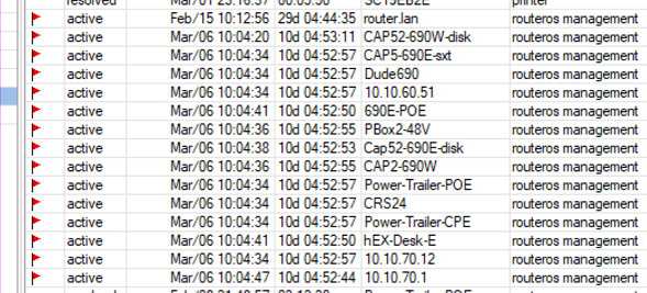

When I upgraded ( I think 6.44) ALL devices went from Green to Orange due to Routeros management timeout. This used to happen when Password was not correct. Does ROS management use the same ports as winbox? 10 days ago I did something to stop ALL Dude 6.44 ROS Management Responses. ROSManargment is running and polling.
Any clues? Should the Service Mikrotik and ROS Management need to be running?
Solved-I changed the winbox port on the edge router. Not sure why this would have killed the service to devices on local subnet?
