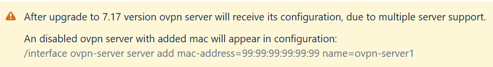

I checked some sections of the E50UG configuration (v7.23.5) using the export file...
and found an odd entry:
/interface ovpn-server server
add mac-address=FE:E8:3C:30:E8:AC name=ovpn-server1
Clearly, this entry was not intentionally added to the device configuration by the administrator (me). :wink:
Investigation results: The ROS documentation ( OpenVPN - RouterOS - MikroTik Documentation ) notes:
And now, the Pub Quiz!
Round 1
• Q1: Who can tell me the purpose of this "disabled" configuration entry? (Why was it created?)
• Q2: What specific part of this entry indicates that the server is disabled?
• Q3: Why does this entry not appear in the Winbox UI or when running the /interface/print command?
Round 2
Q1: How can we be sure there are no other hidden 'server' or 'client' entries missing from the UI, print command, or configuration export?

R1 Q1: You want a copy-paste of the image, or you are not able to read one image?
R1 Q2: The missing disabled=no
R1 Q3: Interface? What interface? Is on PPP OVPN server.
R2 Q1: In the same way that you are sure it isn't raining meatballs.
R2 Q2: C + daily "diff" or better R2-D2 + C-3PO
R2 Q3: None of the above but: The entry is removed.
Or the missing enabled=yes? :astonished_face:

What is the output of:
/interface ovpn-server server export verbose
Di solito... non scrivo a caso... :roll_eyes:
@aldek would answer
add auth=sha1,md5,sha256,sha512 certificate=*0 cipher=blowfish128,aes128-cbc \
    default-profile=default disabled=yes enable-tun-ipv6=no ipv6-prefix-len=64 \
    keepalive-timeout=60 mac-address=FE:E8:3C:30:E8:AC max-mtu=1500 mode=ip \
    name=ovpn-server1 netmask=24 port=1194 protocol=tcp push-routes="" \
    push-routes-ipv6="" redirect-gateway=disabled reneg-sec=3600 \
    require-client-certificate=no tls-version=any tun-server-ipv6=:: \
    user-auth-method=pap vrf=main
disabled=yes
Yes, you are right.
I should have dug deeper, but I was hoping in vain for logic in the ROS hierarchy—it's not guaranteed that you will get information about objects one level lower at a higher level.

Regarding
Let's look at the logic: if this entry did not exist before version 7.17, then it must have been introduced in the v7.17 update code, just as the documentation states.
This means the entry was created by RouterOS update v7.17.
When you say 'The entry is removed.' and immediately deny that it was done by RouterOS update, then tell me: do you know how it was removed?
It could only have been done either by RouterOS update or manually by the administrator.
So does the RouterOS version really have nothing to do with it?? :wink:
And I repeat: why is it that, despite running identical RouterOS versions, some devices (E50UG) have it while others (hAP ax2) do not?

The newly created entry inherits its settings (if any) from single OVPN server config from older versions. It could be argued that if there were no changes to it then entry should not be created though as there is nothing to preserve.

@rextended The point of the questions is to show that for unexplained reasons, when updating Roteros, configuration entries may appear that cannot be explained in any way.
Moreover, developers subsequently forget about them and it remains as "garbage" in the configuration.
The first question was: What is the purpose of this entity?
You didn't answer it.
And you answered the question about deleting the record by trolling - the entity is deleted. It's like answering the question: why clouds move? - because they change their position.
And one more question - has anyone tried to calculate how many resources are spent on converting "Disabled=yes" from configuration to "Enabled=no" in the Winbox user interface?

Other users in this thread have already told you the reason,
not to mention the fact that it is still stated in the guide you took a screenshot yourself...
@eider
:heart_decoration:
It's a good thing I'm not the only "Сelestiale being" here...
At first (until 7.16.x) it was only possible to have one,
then they introduced the option on 7.17 to have more than one,
so the existing one (even if unused) is created anew, exactly as it was, as the first entry in the new multiple-entry database.
The way it was handled is correct: it avoids any issues regarding judging whether or not it was actually being used.
