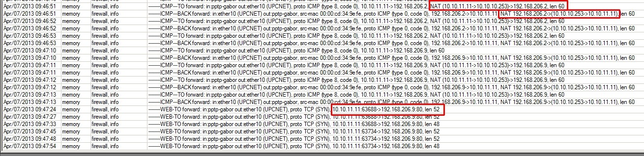

I have the feeling, that the rc12 has some bug. I have 4 log rule at the beginning of the forward chain: 1. icmp to the other end, 2. icmp from the other end, 3. dst port 80 to the other end, 4. src port 80 from the other end. My log is attached. As shown in the “log.jpg”, the icmp traffic to the same ip (192.168.206.9) is natted, the web traffic is not. Miss I something?

Once again: the strange thing, that the icmp is natted, the tcp traffic is not…
