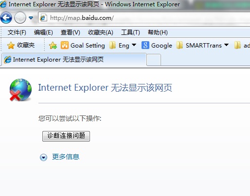

when I click through hyper links , for example from http://www.baidu.com, I can get random connection time out on a link, but if I come back after some time, I may be able to get in the link quickly.
it’s not website problem, I tried on my tablet thru 3g connection, every link on that site worked perfectly.
Why the routerboard get connection choked on web browsing? my ROS is 5.24, the latest, the CPU load is about 20% on that hyper link click.
and it’s not browser issue, I tried on different laptop using the same wired connection to the ROS router, using Chrome, get the same result, not failed on the same link, but get failed on other link. and it’s not limited to that site, I tried other site, local search engine site like http://www.soso.com.
So I believe it’s routerbord or ROS issue.

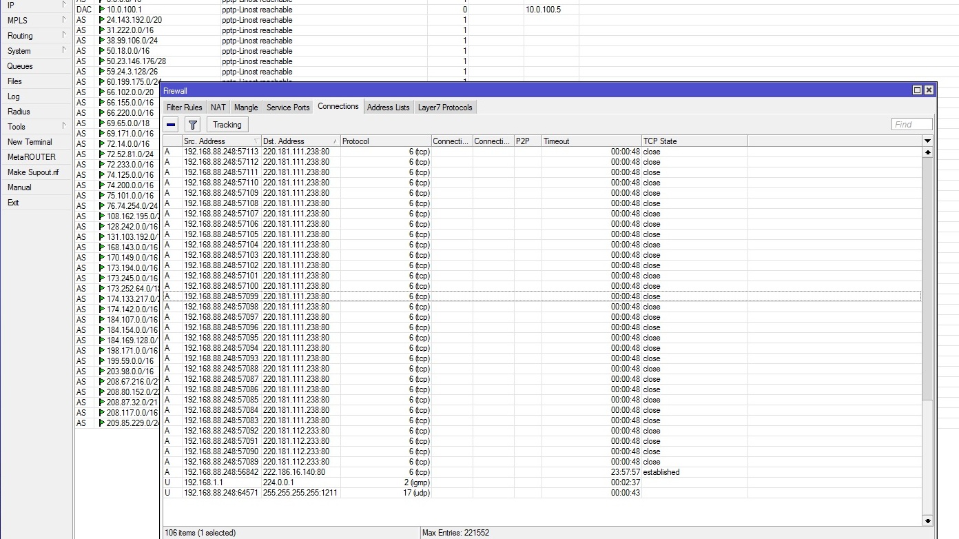

Now, I watched the firewall connection, on my click the hyper link, there was no response, I saw a lot of connections created in the firewall connections window. and finally I got
connection time out error from Chrome: “Connection Timed out” error.
Please see attached picture of the firewall connections. a burst of connection creation after click the hyper link and finally the connection get closed.

Actually, I have PPTP connection only takes part of outbound request to some banned site by chinese great firewall. most of the connections, including the “timed out” links are local Chinese sites, go through the normal pppoe connection.
I feel it could be ROS NAT function instability. because the timed out links randomly have this behavior. and all links worked well on my phone or tablet using dedicated 3g connecction.
