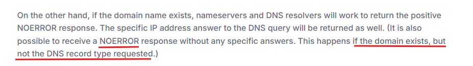

This is totally wrong, please read up on what NXDOMAIN really means. And then you’ll understand why NXDOMAIN is not cached with the record type:
https://bluecatnetworks.com/blog/what-you-can-learn-from-an-nxdomain-response/
NXDOMAIN means “non-existent domain”, which is returned when the domain does not exist at all, NOT when the domain exists but doesn’t have the record type being queried. In case of an AAAA query, if there exists any other record for the domain (SOA, A, MX, etc…) NOERROR should be returned, not NXDOMAIN, and the result for AAAA is just empty:

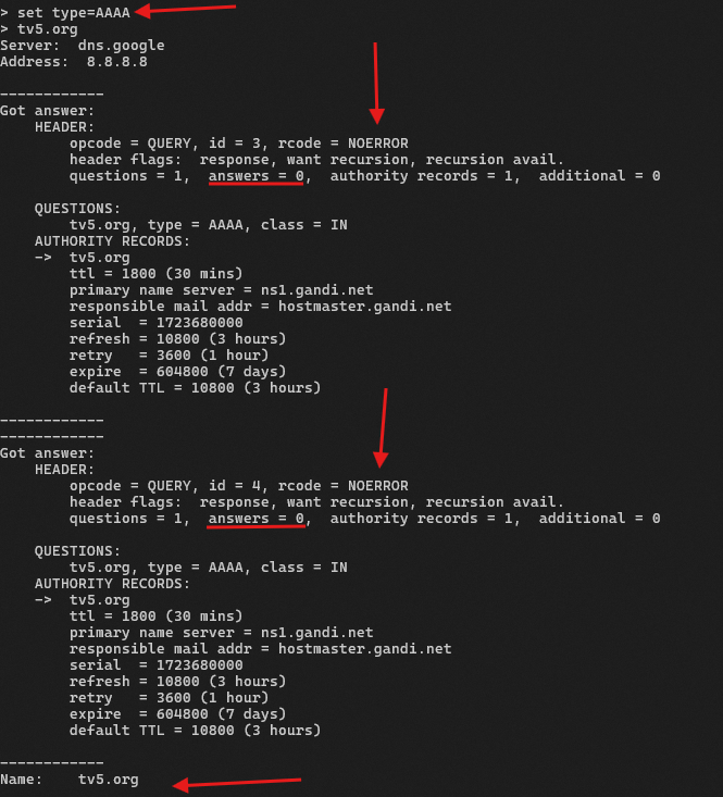

Here are some tests for you. First is a type=A query for a domain that only has IPv4:
As expected, we get NOERROR and answers=1, and the IP address. Now let’s query for the AAAA record, which does not exist:
As you can see, the code is still NOERROR, and not NXDOMAIN like you thought. The answers is empty (answers=0) because the AAAA record does not exist.

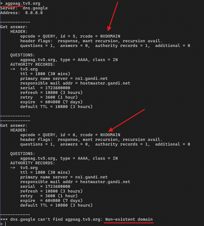

You only get NXDOMAIN when you query for a domain/subdomain that does not exist (has no record at all):
I hope that now you can see that it doesn’t make sense to save the record type with the cached NXDOMAIN result! You should either replace your DNS software or configure it so that it correctly returns NOERROR for an AAAA-query when an A record (or any other record type) is present but no AAAA.
