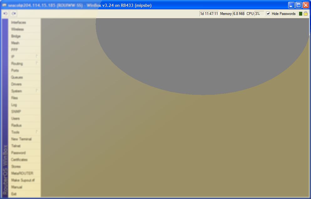

I am not too sure about 3.24 either. I saw leak in 3.24, so I upgraded to 3.27 hopping that it will resolve the memory leak issue. Please see attached 3.24 memory leak just after 1 day on a rb433.
Sans.
