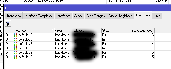

I notice that in V7 OSPF neigbors are listed as dynamic - Is this correct ?
Should I add static neighbors ?

With V6 we created OSPF interfaces for our /30…etc but in V7 I note that all our Neighbors are dynamic
Can I also ask as we are using L2 bridged VLANs throughout our network, is the creation of Static Neighbors recommended !

(1) When using /24 broadcast state=init between 2116 to HEX 5 port
(2) When setup as a test to the same Hex 5 port using /30 PTP I have state=full on the 2116

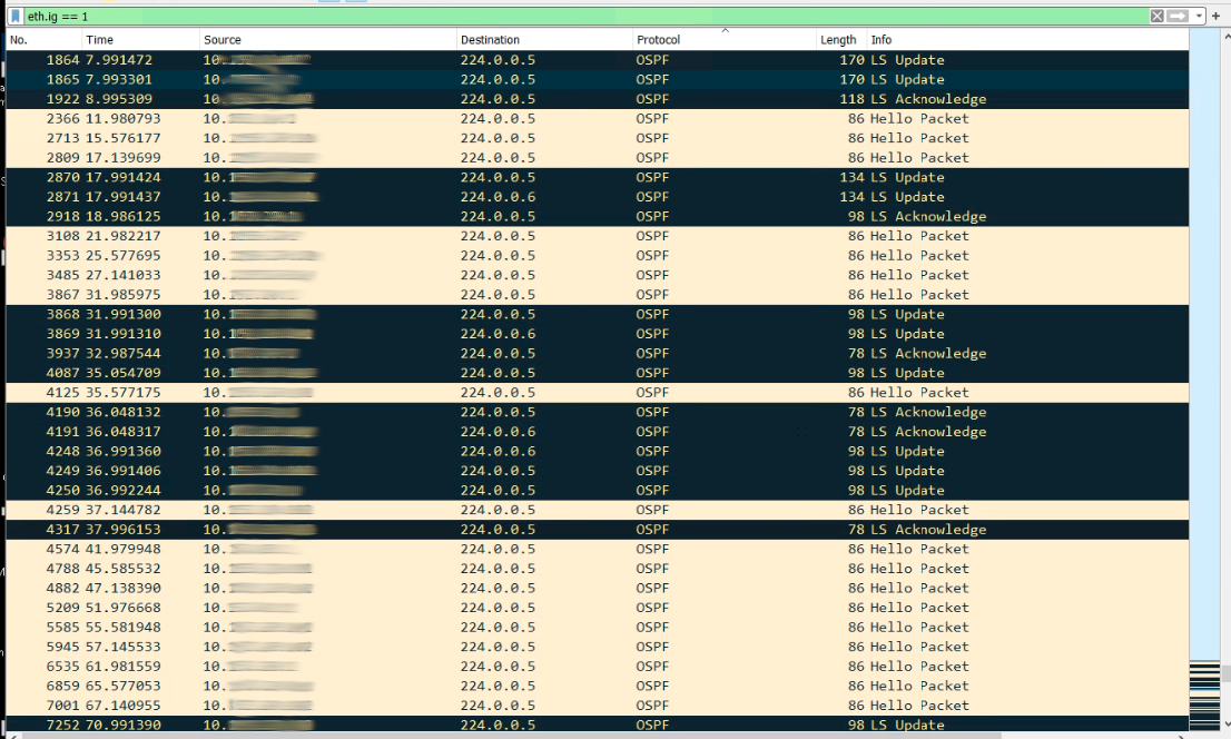

I used packet sniffer then opened with wireshark (attached) and it reporting OSPF packets from devices but still the CCR2116 stuck in state=init?
