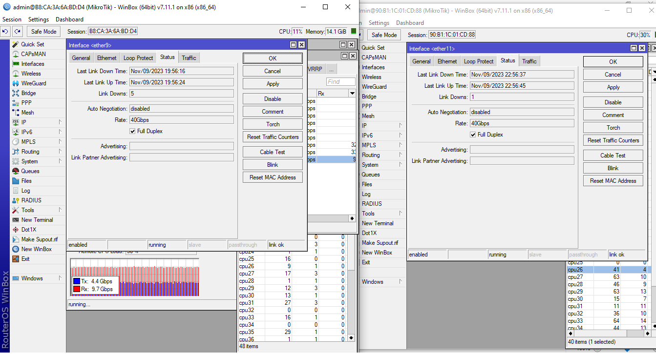

So i have tested with DAC 40GB cable.. with autonegotiation off.. it will not link 40GBps full-duplex.. so i removed the dac and placed 40gb gbic with cable and it linked full duplex 40gbps on both servers..

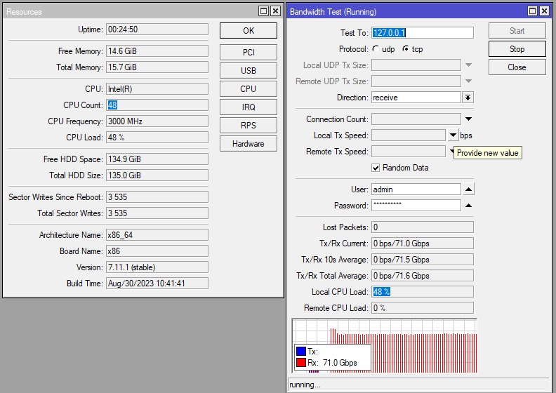

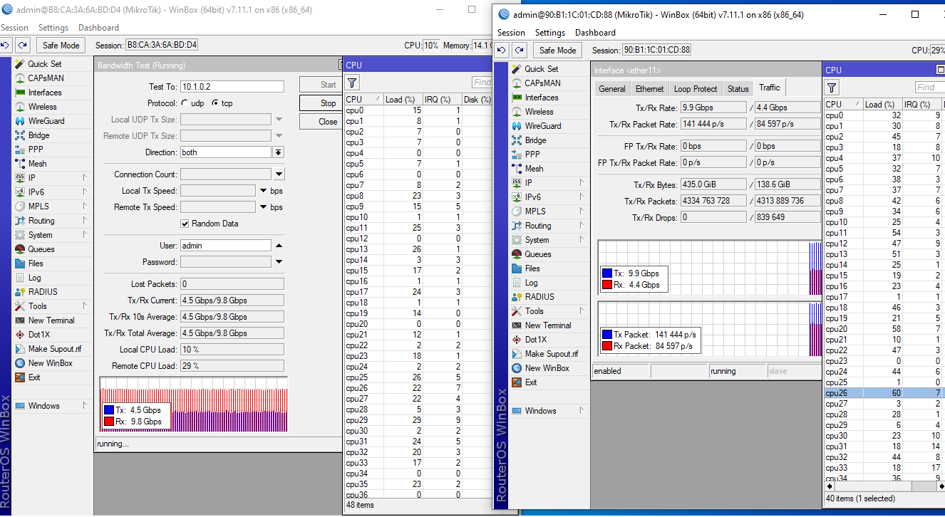

so i did some testing with bandwith test server.. and TCP running both sides.. i can only get 15Gbps aggregate traffic.. cpu wise running average 20% to 30% on both machines.. it seems to be something on the network side so i tried out.. jumbo frame set 9800 on both ethernet adapters as shown on pictures below.. but i cannot get past 15gbps..
if i do internal core test local on the server i can get nearly over 60gbps internal on the cpus TCP packets.. but on the network interfaces cannot get past 15gbps aggregate.. wondering if its software wise or hardware wise on the servers?

continuing testing.. it seems that advertise on Mikrotik running the MCX354A-FCBT in ethernet mode switch… advertises ports as 5G FULL..
strange.. even disabling auto-negotiation and seting 40Gbps… it wont go past 5gbps in TCP.. in UDP it goes both tx and rx in 9.8GB forward test..
i am testing packets forward and backwards on bttest between the 2 servers.. any ideas if this could be a limitation on the PCIe ? or its a license issue on mikrotik? i am running evaluation test firmware latest 7.12.xx stable.. with 24h trial with no license.

ok guys so after some more searching it looks like its a hardware limitation on the Dell R620 and R420 sides… based on the speeds of the PCI-e 3.0 slots.. of max 16G aparently there are some tweaks available and tunning but it seems to be base on the R630 and R730.. so next stepp will try to get hold of 2 units for testing.
Networking with 2 CPU(s) is bad. Because the pcb lane on pcie are directly to 1 CPU socket. If all cpu plugged but only 1 pcie, the traffic will flow to another cpu and go back again through a lane called QPI. QPI is natural enemy for networking, latency and jitter. Please read about Networking with NUMA. Or you can take out the cpu that not direct to pci lane you, you will got better performance except your cpu is too old.
I used R620 with FRRouting + dpdk on 2690 v2.
Got 8mpps performance on single core, and got 16mpps on 2 core in same cpu socket. But when i pin 1 core on cross cpu socket its only 12mpps, thats it.
