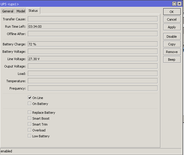

Using the included APC PowerChute Business software, on a win7 machien (or VM) and connected to teh UPS via USB - im able to get lots of data such as Line Voltage input, current load (in VA and Watts) ect..
I know that the rOS UPS extra pakcage allows most (or all) of this data to be extracted as well, however im only able to get the data below ( on rOS 6.37.3 , same version for the extra UPS pkg) :
/system ups> pr det
 0    name="ups1" port=usbhid1 offline-time=5m min-runtime=5m
      alarm-setting=immediate model="Smart-UPS C 1500 FW:UPS 10.0 / ID=1005"
      serial="AS1532115065" manufacture-date="2015-08-08" on-line=yes
      nominal-battery-voltage=24V
  /system ups> monitor
numbers: 0
         on-line: yes
    runtime-left: 8m
  battery-charge: 100%
    line-voltage: 27.3V
 EXPORT:
 /system ups
add min-runtime=5m name=ups1 offline-time=5m port=usbhid1
(also see my attached screen shot from winbox)
Is there anything i can do, or data i can provide to Mikrotik such that i can see/get the additional data (current input voltage, current utilization in Watts) from this APC UPS? - i also think that the line voltage being displayed, is in-fact the Battery Voltage (so maybe its something that needs to be tweaekd with the driver rOS is using?)
I know the rOS UPS extra package supports pulling this extra data (as ive seen screen shots of others with APC UPSs showing this data in winbox)

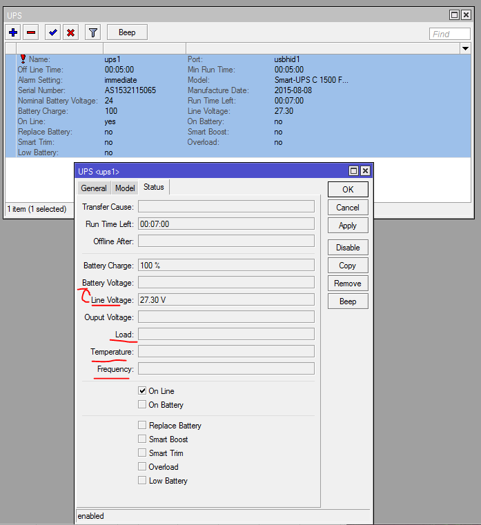

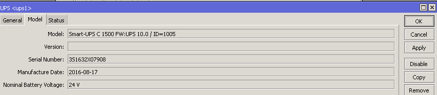

Hi
I have the same issue with my UPS. My other smaller APC seem fine. What do Mikrotik need in order to resolve this?
I’m hoping threads (and support emails) like this might bring it to supports/my Dev’s attention, it’s obviously something they need to add or tweak.
I emailed Support about three weeks ago with as much information as I could provide (sup out and data from APC) but I never heard back from mt support.
Tks for confirming this though.
