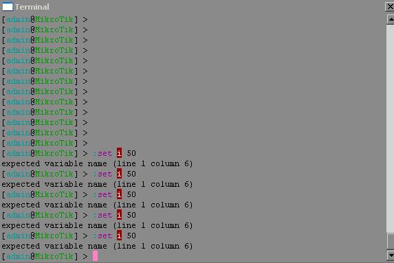

Ros4.02bet verson set a variable can't work?
like this: if I type “:set i 50” in the teiminal as usual previous verson, the variable “i” become to display brown, means error. No matter what i have tried ,it can’'t work, why ? Who can tell me how to set a variable in verson 4.02? Thanks a lot.

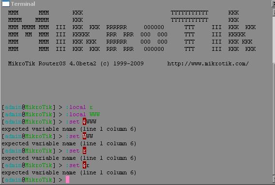

I have declared,but it remained,It seems like a bug , and i have tangled it two days! /Who can tell me why ??? Did anybody ever encounter it before ?
Each command line is separate script, so local variable is not defined in second line.
To make this work use {}
:local test 1;
:put $test;
