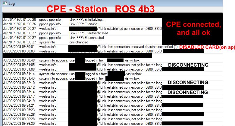

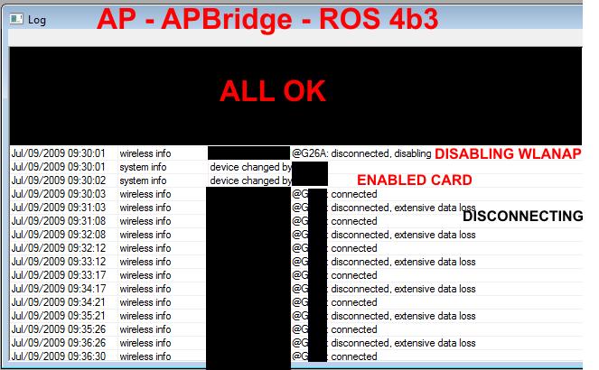

When AP and CPE is power on then all OK but when I disable and enable card on AP then CPE disconnecting and connecting again with message:
On CPE: Lost Connection, not polled for too long, on AP: disconnected, extensive data lost.
And this disconnection repeat every 30-60 secounds again, and again.
STOP disconnecting when I reboot CPE then CPE connected and all ok until I again change configuration on AP or diable/enable.
