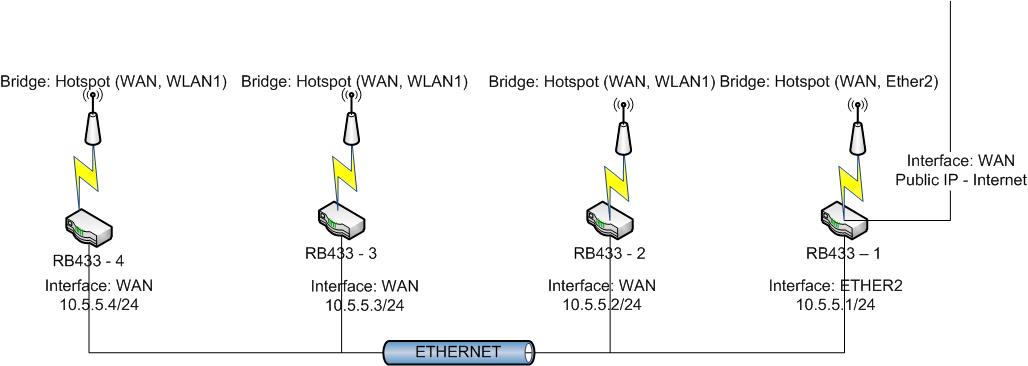

I have been testing different things in past week, hoping for an answer but here is what I have figured out.
The attached image is my network.
Main RB433 has internet connection and is running hotspot on the interface hotspot (Bridge consisting of Wlan1 and Eteher2).
Other routers have the same hotspot bridge but with interfaces WAN and WLAN. The names of the interfaces are irrelevant but I have named them for easyer identification..
On the hotspot server I have made IP Bindings for WAN interface of Routers 2 to 4, but MAC address is changing sometimes it shows MAC for WAN interface and sometimes for HOTSPOT (bridge interface).
It does not matter if I put IP address on bridge or WAN interface of Routers 2-4. When MAC changes I cannot access routers 2-4 from Router 1 as long as I am running hotspot server. If I disable hotspot server I can connect and the ping comes back with replies.
This was a working live setup for over I year on ROS v3.x (3.15-3.30). It worked with now problems.
So I have downgraded one router (RB433 - 2) back to 3.30 and for now it is working again with no problem only one MAC is popping up in hotspot hosts..
I think the problem starts when people connect to WLAN interfaces…
Can anybody confirm my problems?
Did Mikrotik changed something in bridging?
