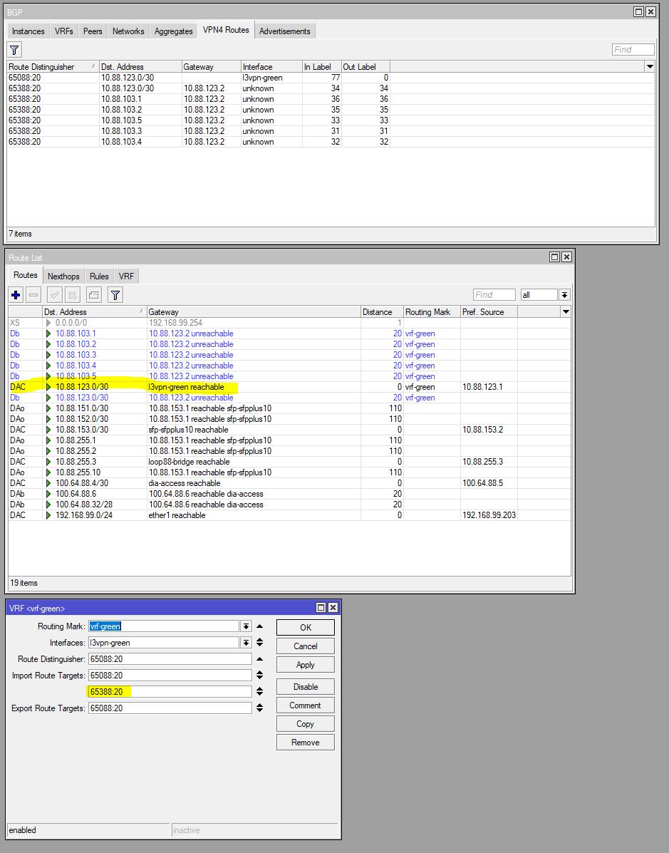

I think you have the following errors in your PE config:
  • the non default BGP instance in vrf-green is disabled.
  • the BGP peerings between PE an CE are not using the default BGP instance.
  • you are using VPNv4 address-family instead IP address family in the peering to the CE.

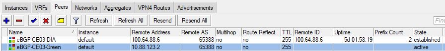

I have enabled the IP/VPN4 address families on both PE-CE peerings and disabled multihop. The VRF peering is not coming up and this was the initial prompt for this post.

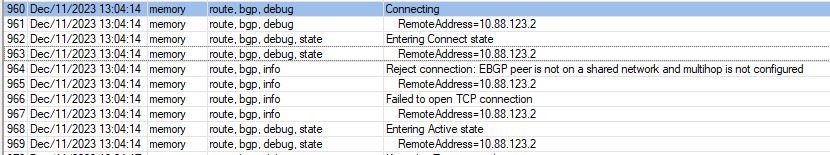

I have disabled the following route rules and now I can only ping across with the vrf mark applied.
PE:
[atetu@mpls-lab-pe03] > ip route rule print
Flags: X - disabled, I - inactive
0 src-address=10.88.123.1/32 dst-address=10.88.123.2/32 action=lookup table=vrf-green
CE:
[atetu@mpls-lab-ce03] > ip route rule print
0 src-address=10.88.123.2/32 dst-address=10.88.123.1/32 action=lookup table=vrf-green
[atetu@mpls-lab-pe03] > ping 10.88.123.2
SEQ HOST SIZE TTL TIME STATUS
0 no route to host
1 no route to host
2 no route to host
sent=3 received=0 packet-loss=100%
[atetu@mpls-lab-pe03] > ping 10.88.123.2 routing-table=vrf-green
0 10.88.123.2 56 64 0ms
1 10.88.123.2 56 64 0ms
2 10.88.123.2 56 64 0ms
3 10.88.123.2 56 64 0ms
sent=4 received=4 packet-loss=0% min-rtt=0ms avg-rtt=0ms max-rtt=0ms
What is preventing the BGP to establish on the VRF enabled /30 link?

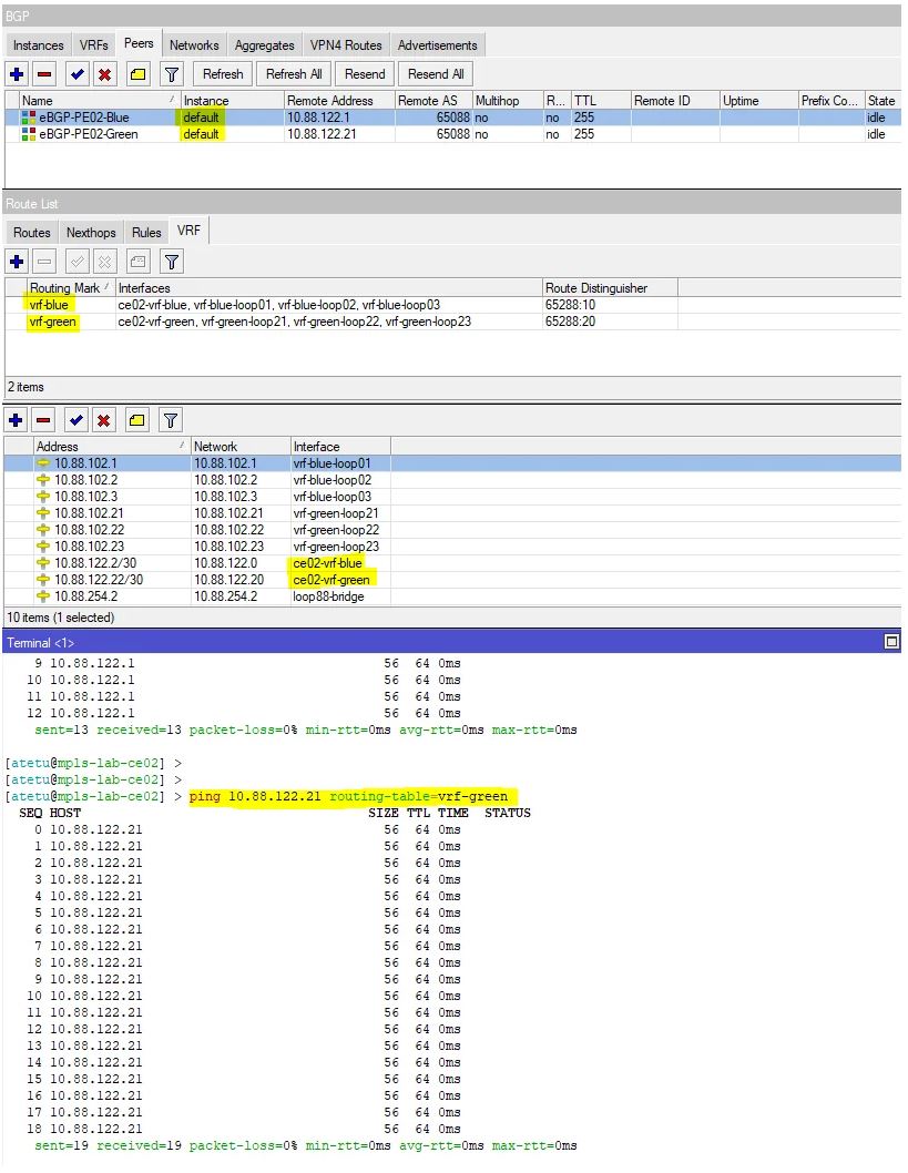

I’ve been working on my “PE02-CE02” setup this morning where I have two VRF peerings instead of 1 VRF and 1 DIA peering. Same result unfortunately.
