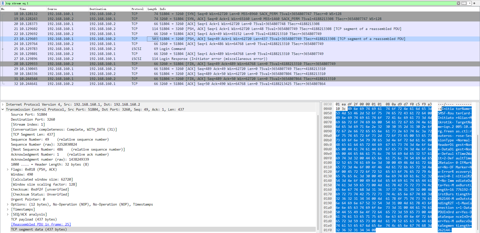

And I captured some packet from the NAS host side.
The initiator name from router card is the identity I was given to it “SMSF-RouterCard”, and clearly SCST doesn’t like this.

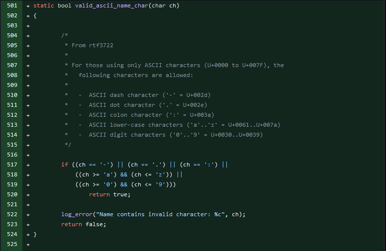

I went to the source code of SCST, and found out this commit (the code comment “rtf” seems to be a typo):
And this naming limitation was indeed existed in RFC3722.
on page 2.
This commit was merged 3 months ago, and It seems TrueNAS Scale have updated their SCST service contained this code.
