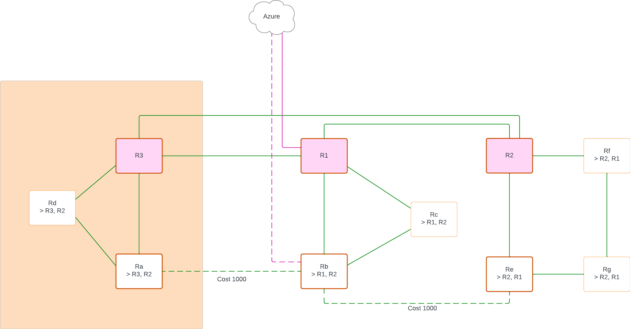

I attached a simple diagram of the current setup.
The pink routers R1, R2, R3 are the route reflectors. Those are of course fully meshed.
Routers Ra…Rg are the rout reflector clients.
Those are peered to the local RR, as well as to one of the others, the corresponding RRs are specified in the diagram.
IGP is OSPF, redistributing only the loopback IPs.

R1 does have an additional instance with a different AS# to ebgp peer Azure. A second one will be added to Rb as soon as we got the rest stable.
So, to get the prefixes announced from Azure to our own iBGP, we added a new instance with our own AS# and enabled “redistribute-other-bgp=yes”.
Those Azure prefixes get propagated just fine to:
  • all RRs (iBGP peers without reflection)
  • all rr-clients peered directly with R1
but those rr-clients, that aren’t directly peered with R1, but with R2+R3, won’t receive the Azure prefixes.
The rr-clients that are peered with R1+R2/3 are getting the prefixes only once, directly from R1.
R2 + R3 aren’t showing the Azure routes in /routing bgp advertisements either even though the filter would allow them (are the same as on R1).
So… to give you some more insights, here’s the config of the “problematic area” marked in orange in the diagram. R1 + R3 + Rd to contain two RRs and one rr-client missing the routes.
