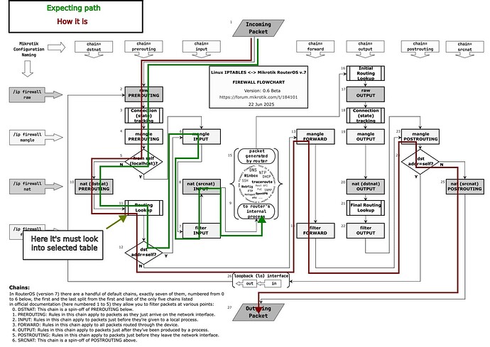

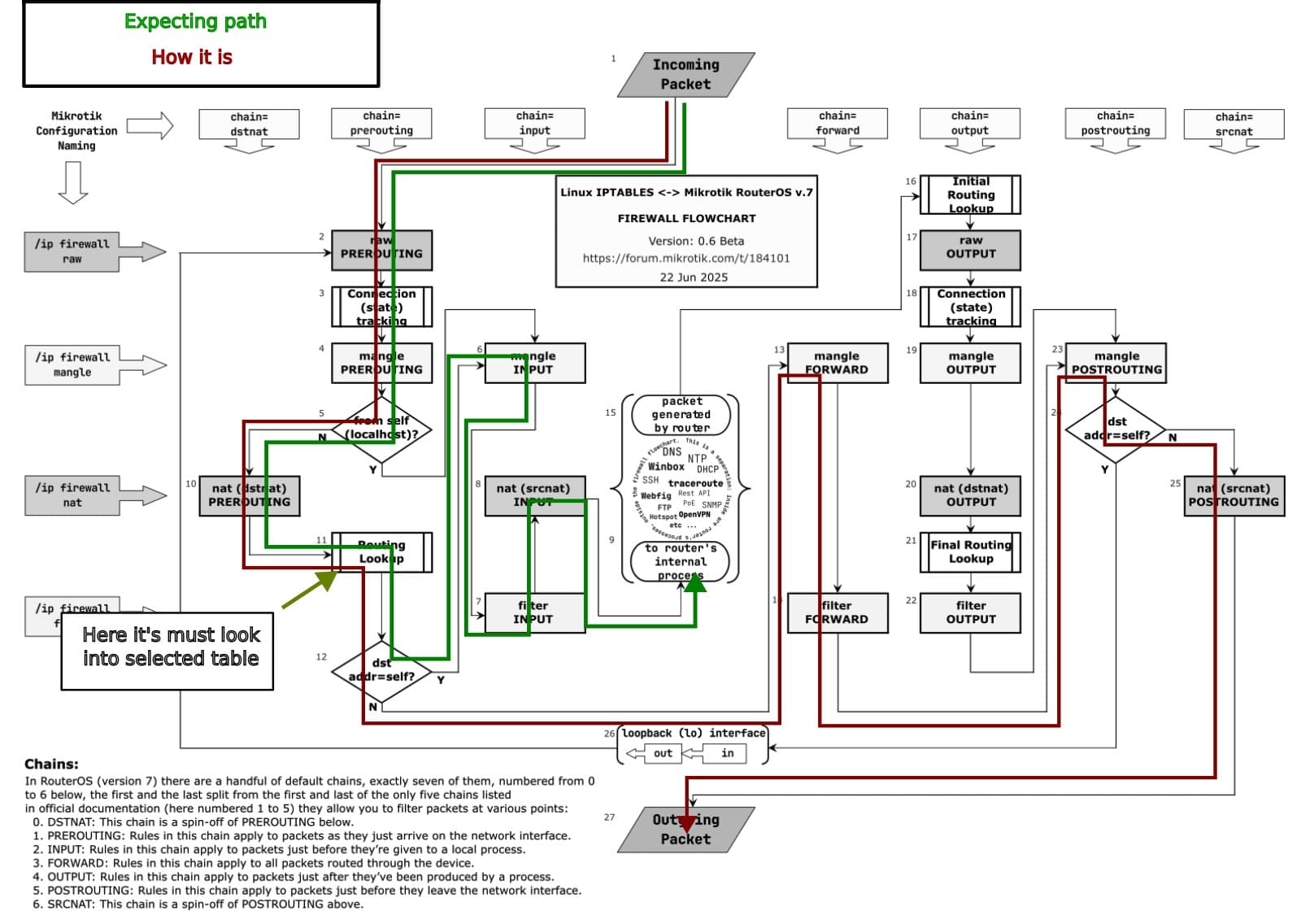

But it’s really seems bug, because it’s break official routing diagram:
Here after prerouting and change routing mark for packet next is “Routing decision”, and after this it’s goes to “input” or to “forward”. I add few log rules into input and postrouting chains to detect where does the traffic go. And for local 192.168.0.1 IP it’s goes to outbound interface!
To summarize - it’s broken in ROSv7. Yes, it’s can be go around, but it breaks flexible policy way for routing.
@zidane
Can you check and describe what happens using this diagram as reference (specific for version 7)?:
I am not sure to understand if there is the need to add a note to it or if what you experience is "normal/expected".

If you consider that when writing new-routing-mark=xyz in action=mark-routing mangle rule, you are not specifying the routing table, but the VRF (including the implicit, hidden VRF) then what you observed can easily be explained. Let's look at the diagram from @jaclaz thread:
At #4 (mangle prerouting) you set the routing mark that choose the "VRF" mytable (implicit VRF), at step #12 a decision is made for dst-addr=self?. But, as I wrote above, in this implicitly created VRF mytable the router has no interfaces and no IP addresses. So, this check yields "N" and the next step in the flow is #13 (mangle forward), the INPUT chain is completely bypassed. The FORWARD chain will only send the packets to the out interfaces, even when you've explicitly added the dst-address=192.168.0.0/24 route, the gateway is the out interface bridgeLocal.
To give even more weight to the hypothesis, you can do the following experiment on your router:

If you do the tests now, you'll see everything behaves exactly like your original configuration. Client 192.168.0.11 uses the vpn gateway to go to the internet. But is unable to access 192.168.0.1.
And the reason it's unable to access 192.168.0.1 is because in the mytable2 VRF, the router doesn't have the IP address 192.168.0.1. At step #12 of the flowchart, the comparison produces false. The packet will be sent to vpn (if you don't have the 2nd route) or to bridgeLocal (if you have the second route).
How can you make it works? Very easy, we just give the router the IP address 192.168.0.1 in the VRF mytable2!
add address=192.168.0.1/32 interface=dummy network=192.168.0.0
Note that the netmask or network doesn't matter here, we just need the router to have the IP address 192.168.0.1 on one of the interfaces of the mytable2 VRF, in this case the dummy bridge is the perfect candidate interface.
Once this change is made, at step #12 of the flowchart, the check will produce true and the correct INPUT chain will be used (#6 mangle input is the next step). You'll see that 192.168.0.11 now has no problem accessing the router at 192.168.0.1 anymore.
I think if we accept that "creating FIB table creates implicit VRF with no interfaces" then the behavior you observed can be explained quite well.

Faced similar issue after updating to Ros7.20, where my mangles suddenly stopped working. After trying different mangles configuration without success, I finally “moved” all configuration into /routing/rules.
I've created a support ticket asking MikroTik to clarify the behavior that OP sees in this thread. Support has summarized the behavior and I am pasting the extract from their responses here, because it's more detailed than that is in the documentation. In these situations (what in quotes are MikroTik's words):
In summary:
  • linux splits "main" table and "local" table, where local table contains all locally reachable addresses from the main table.
  • "main" can reach only addresses from internal "local" table.
  • there is no "local" table for any of other VRFs except main
  • VRF can reach only addresses that are set on VRF interfaces
  • mangle rule overrides any subsequential routing rules
Further beta versions will expose the use of "local" table and will have the possibility to override the sequence of rules, current behavior represented in routing rules is like this:
[admin@CCR2004_2XS_111] /routing/rule> print
Flags: X - disabled, I - inactive; * - default
0 * action=mangle
1 * action=lookup vrf
2 * action=unreachable vrf
3 * action=lookup table=local
4 * action=lookup table=main
When VRFs are involved, and the destination address is one of the router's addresses (but can also be an address not in the chosen VRF):
  • Setup: you have a mangle that redirects to VRF and VRF does have an address
    Result: first rule performs the mangle action and due to adjusted routing mark performs vrf lookup. destination is resolvable in vrf -> process the packet locally
  • Setup: you have a mangle that redirects to VRF and VRF does not have an address
    Result: first rule performs the mangle action and due to adjusted routing mark performs vrf lookup. destination cannot be resolved -> drop the packet
  • Setup: you have a mangle that redirects to VRF and VRF does not have an address but has a default route
    Result: first rule performs the mangle action and due to adjusted routing mark performs vrf lookup. destination resolved by defautl route-> forward the packet
When routing mark does not point to a VRF:
  • Setup: You have mangle rule, you try to reach forwarded address that cannot be resolved in custom table
    Result: mangle action performed, lookup in custom table -> destination is not resolved, fallback to the main table -> packet is forwarded
  • Setup: You have mangle rule, you try to reach local address that cannot be resolved in custom table
    Result: mangle action performed, lookup in custom table -> destination is not resolved, fallback to the main table -> destination is resolved using routes in the main table (this part is important, because fallback is to the main table not "local" table)
Thus (the mentioned exception was dst-address-type=!local):
As you already mentioned yourself there must be exception for "local" traffic when setting mangle rules (unless there is specific need to override resolving destinations in local table).
When there is no mangle rules:
  • Setup: You do not have mangle rule, you try to reach forwarded address
    Result: mangle action skipped, vrf lookup skipped, lookup in "local" table skipped, resolve the destination in main table -> packet is forwarded
  • Setup: You do not have mangle rule, you try to reach local address
    Result: mangle action skipped, vrf lookup skipped, lookup in "local" table resolvse the destination -> packet is processed locally
And this is their conclusion:
That is the current behavior that in current version cannot be altered.
From my understanding of reading through this, the case in the opening post is the bolded paragraph above. It falls back to main and not local thus there is no match with the local addresses.
So it's NOT a hidden VRF like I speculated!
Well, that’s going very strange because it’s worked with routing rules, but seems it’s switch table on routing decision…. may be rules apply after some tings already happen, or may be we still have “local” table context attached at this point. And when it’s happen with mangle - it’s already without “local” on routing decision.
@CGGXANNX
It seems to me that your speculation about "implied, hidden vrf" has been replaced by "implied, hidden local table", not that much of a difference, all in all.
But your speculation was easy to understand, the "right" explanation is - to say the least - convoluted.
I've been following Mikrotik's vrf journey for some time now. It's generally heading in a predictable and right direction. Unfortunately this breaks some of the v6 compatible assumptions, while transitioning towards the Linux mainstream.
They are trying to do this gently, but exposing the vrf interfaces, removing the routing table option from features and substituting it with vrf, the addition of vrf support for many/most of the internal services, traces out a clear line.
Exposing the local table is one of the logical next steps.
(I would have bet a significant amount of money when initially reading this thread that the one given was going to be the explanation for this behavior.)
Linux's view of vrfs is nice and consistent, so the change is ultimately for the better. While this is going on, things will unfortunately keep changing little by little
