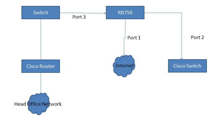

Route 2 Different Network with RB750
RB750 with 2 different Network Subnet
Port 1(ether1-gateway): Internet Connection
Port 2(ether2-master local): LAN1 (Branch Office) - Address 192.168.1.1 (act as Gateway to Internet), 192.168.1.0/21 (Network)
Port 3(ether3-slave local): LAN2 (Head Office) - Address 10.15.165.2, 10.15.165.1 (Gateway), 10.15.165.0/24 (Network)
NAT is only to LAN1, so the idea is, the branch office want to connect to head office or vice versa.

The problem that I am facing it right now is my branch office PC can't ping to Head Office Network, but I can ping the Cisco Router Gateway (10.15.165.1) via Terminal Winbox, but not from the PC.
did i miss something here, sorry for this silly question, I need your help guys.

Sorry for late respond, finally I can connect to other network that behind the cisco router by using masquerade the second ether port.
i can connect to internet and ping other network perfectly, but the next hop is killing me, i saw there’re two next hop on ip-route menu, the first one is the ether2 (cisco gateway) and the second one is the internet. when someone want go to internet, it must be pass the first hop which is cisco gateway, and sometime is stuck (RTO, if I am ping google.com), but if ping inside winbox terminal, there’s no RTO, I tried to swap the next hop between cisco and the internet, the problem is vice versa.
how to make this route on my Windows client working very well? do i need to put two gateway on the client?

That is an interesting description, but maybe posting “/ip address” and “/ip route” might make it clearer.
Did you remove ether3-slave-local from the switch?
