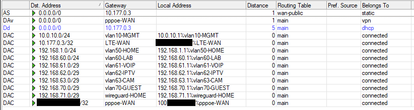

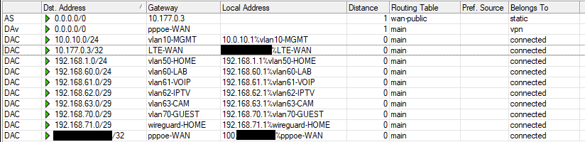

Here is all the other routes. Can you see anything wrong in here? (pppoe-WAN is for the fiber connection)
Unless you mean something else?

You only have one external main route for WAN traffic and thus all your local traffic should use that route.
I think the problem is that you dont have a regular route for the LTE WAN setting.
Either Accept default route in IP DHCP client but set a distance of 5 or something ( advanced tab setting for default route distance ).
OR add manual route for LTE main table and set distance of 5
Then repost the IP routes table.

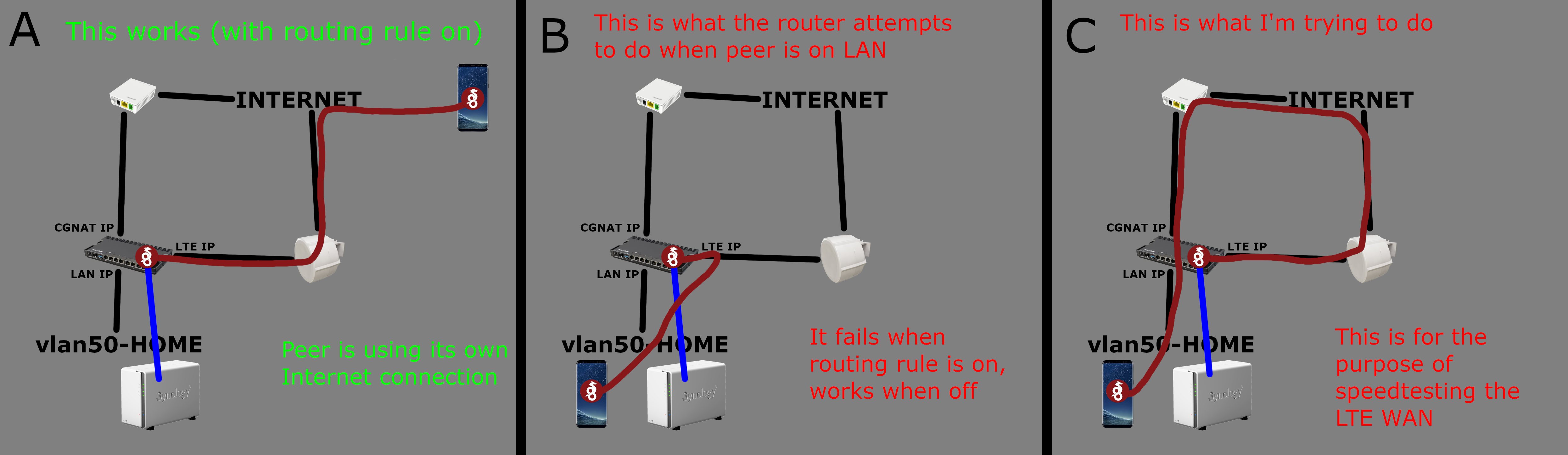

Maybe these drawings will help (edit - updated with better drawings):
I want A and C to work at the same time.
Also, I wouldn’t have to do A and C and use A and B instead (which I also can’t get to work at the same time) if there was an option to select the interface to use in Bandwidth Test.

As for why, I need the “C” way just for the bandwidth test. I wouldn’t need it if there was an option to select the interface that I want to do the bandwidth test on. The fiber connection is much faster than the LTE connection, so that testing through such a loop would show me the speed of the LTE connection. Currently I have to reconfigure everything so that the main default route is on the LTE-WAN every time I want to do the bandwidth test on LTE-WAN, and then changing everything back to pppoe-WAN.
The “B” way is so that the WireGuard connection would work the same no matter if the peer is on LAN or using a different Internet connection. Assuming that both “A” and “B” would work at the same time. So for the WireGuard tunnel doesn’t stop working when the phone switches from LTE to home Wi-Fi. Of course it wouldn’t make sense to keep using it when on home Wi-Fi, but it would make some things more convenient, such as waiting for a large file to finish sending before I turn the tunnel off, or testing a new peer configuration without having to switch to LTE.
