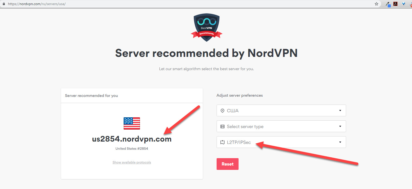

Why does not it work?
/interface l2tp-client
add connect-to=us2854.nordvpn.com ipsec-secret=nordvpn name=L2TP-nordvpn password=xxxxxxx profile=default user=xxxxxx@gmail.com
/ip ipsec peer
add address=us2854.nordvpn.com disabled=yes exchange-mode=main-l2tp generate-policy=port-strict secret=nordvpn (ipisec manual mode)
add address=87.101.95.163/32 exchange-mode=main-l2tp generate-policy=port-strict secret=nordvpn (ipisec dinamic mode)
/ip ipsec policy
add dst-address=87.101.95.163/32 dst-port=1701 proposal=NordVPN protocol=udp src-address=10.153.XXX.XX/32 src-port=1701
add action=accept chain=input comment=“aloow ipsec-ah” protocol=ipsec-ah
add action=accept chain=input comment=“allow ipsec-esp” protocol=ipsec-esp
add action=accept chain=input comment=“allow l2tp” dst-port=1701,500,4500 protocol=udp
/ip ipsec proposal
set [ find default=yes ] auth-algorithms=md5 enc-algorithms=aes-256-cbc,aes-128-cbc,3des
add auth-algorithms=md5 enc-algorithms=3des lifetime=1h name=NordVPN
