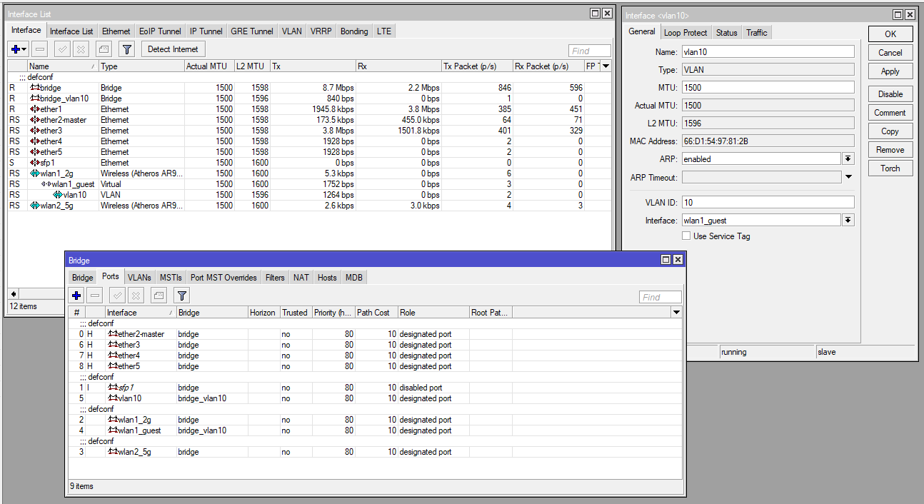

But I said something wrong - I have only one VLAN with ID 10 (guest network with 192.168.1) and my main (192.168.0) is not VLAN, it’s just as it is.
I installed it on my Raspberry Pi, set up VLAN interface eth0.10 and now I need to make both subnets accessible for RPi from that one ethernet port. How can I make it working? I found something about port trunk, but it’s everything for two and more VLANs. Is it possible to do it for VLAN and non-VLAN subnet? How?
I added screenshot of my current config
