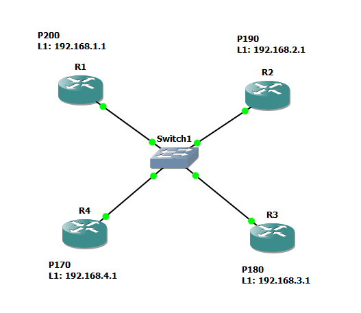

I just proved this issue with real devices - simple 4 routers star with switch in the middle.
R1 - PRIO: 200 - 192.168.0.1/24 - LOOPBACK: 192.168.1.1
R2 - PRIO: 190 - 192.168.0.2/24 - LOOPBACK: 192.168.2.1
R3 - PRIO: 180 - 192.168.0.3/24 - LOOPBACK: 192.168.3.1
R4 - PRIO: 170 - 192.168.0.4/24 - LOOPBACK: 192.168.4.1
Tested with default timers (hello 10s, dead 40s) and custom timers (hello 1s, dead 5s).
R1 is DR, R2 BDR. From R4 I’m pinging R2 loopback. Then I disconnect R1 and wait until dead-interval reached. R2 becomes DR, R3 BDR. Attaching screen record: https://youtu.be/jizkX_4a-CI

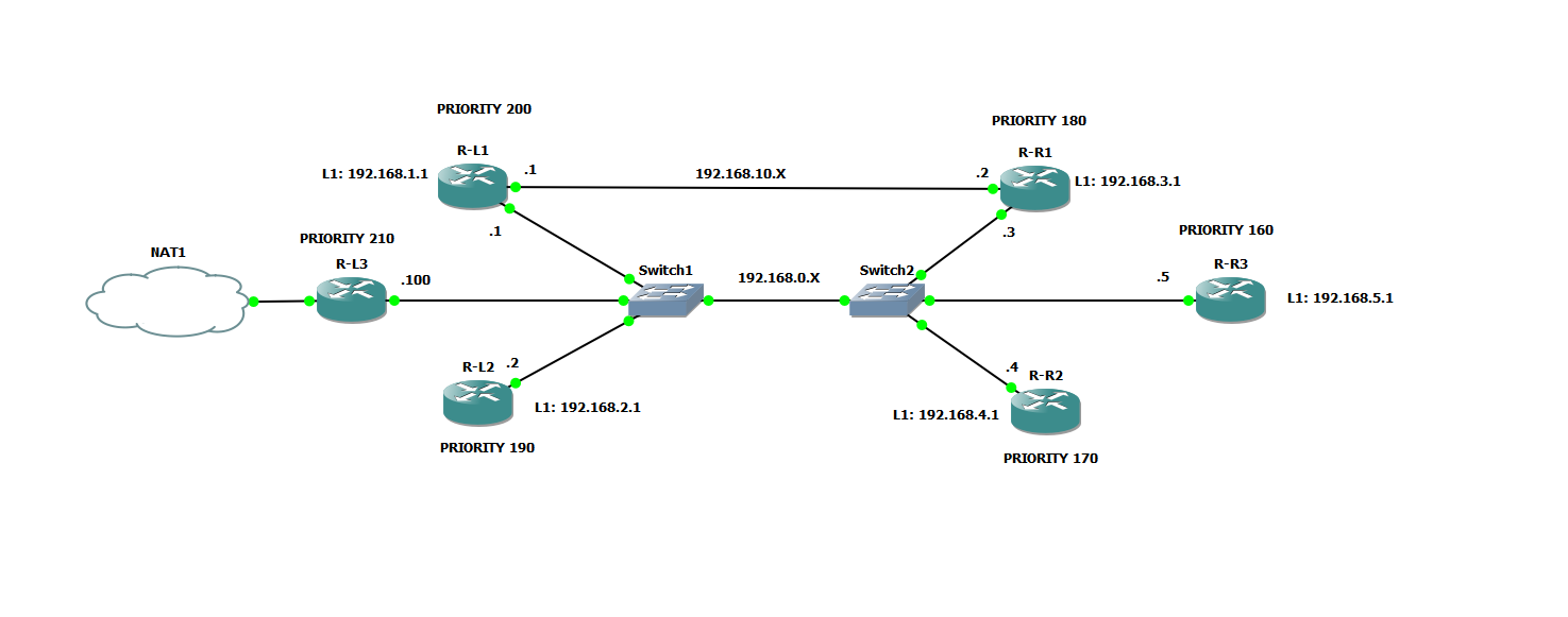

In GNS3 I had little bigger simulation with the same results. Attaching screenshot.
