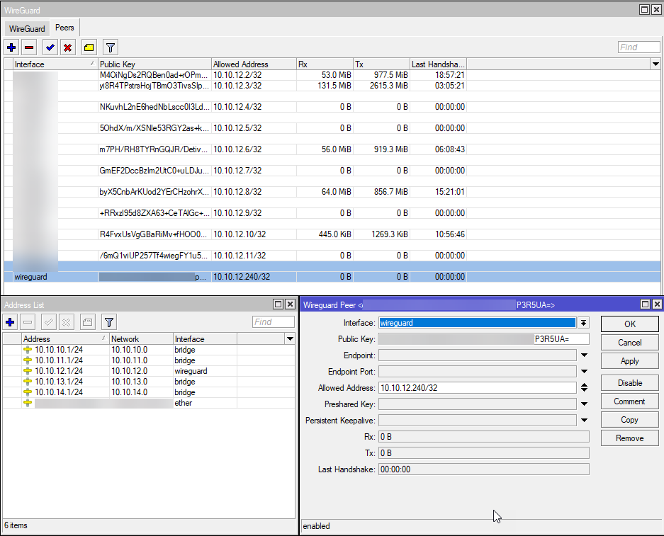

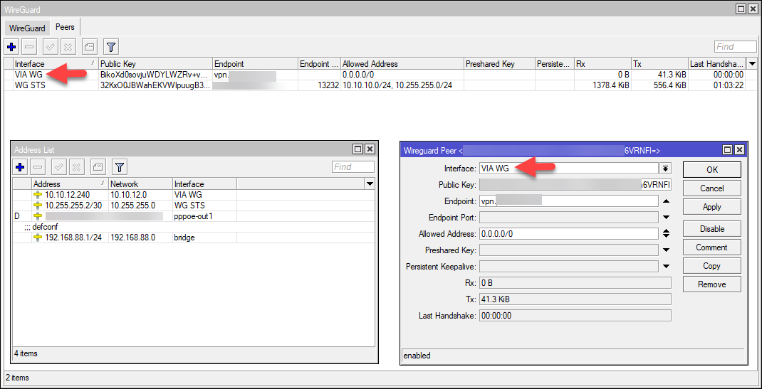

I Cant figure out how to pass a WireGuard tunnel for my MT to a Mikrotik WG peer. My use case is to bypass the ISP firewall.
My MT has two WG interfaces WG STS and VIA WG, WG STS is a Site to Site with a different peer. I’m not sure if that is related to the issue at hand or not.

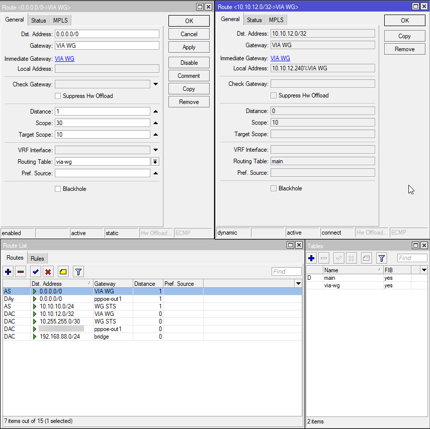

I tried different netmask #4 in the Route list with “VIA WG” gateway. I’m not sure what I have to set there.

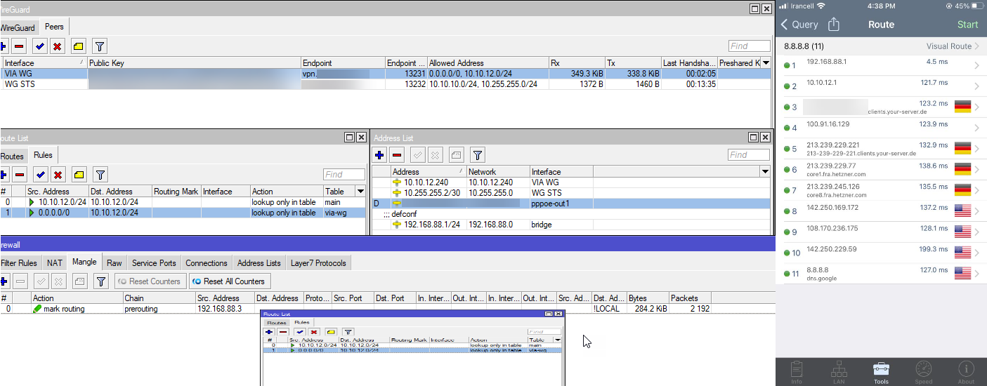

Server Peer & IPs
MT Client Peer & IPs

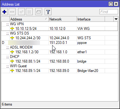

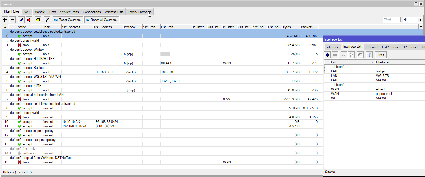

MT Client Firewall - Interface list

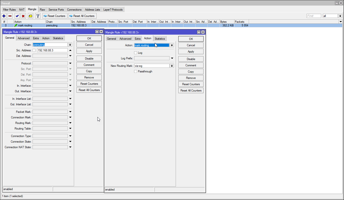

MT Client Mangle
MT Client Route

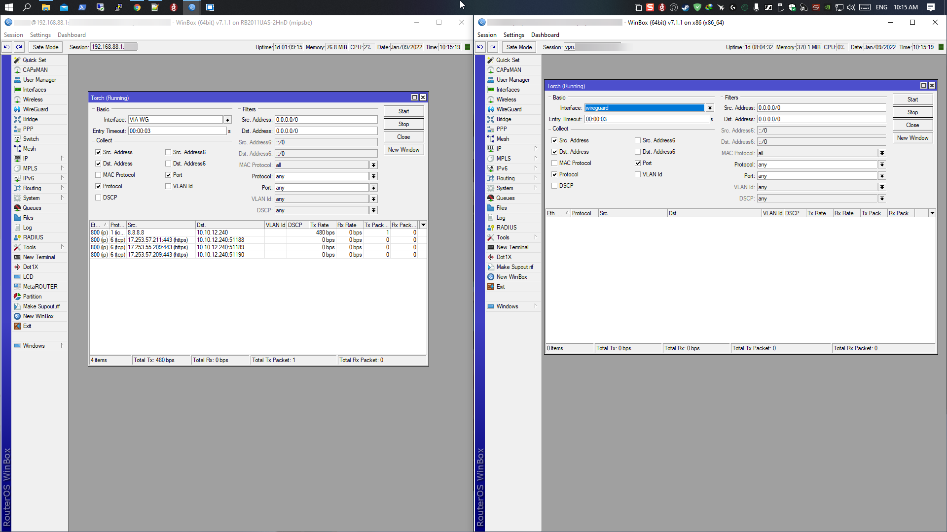

Torch
Found this somewhere in the forum, still cant. The connection is one way I don’t know. the route is wrong, IP/subnet, or combination.
/ip route add disabled=no dst-address=0.0.0.0/0 gateway=WG pref-src="" routing-table=via-wg suppress-hw-offload=no
/routing rule add action=lookup-only-in-table disabled=no dst-address=10.10.12.0/24 src-address=10.10.12.0/24 table=main
/routing rule add action=lookup-only-in-table disabled=no dst-address=0.0.0.0/0 src-address=10.10.12.0/24 table=via-wg

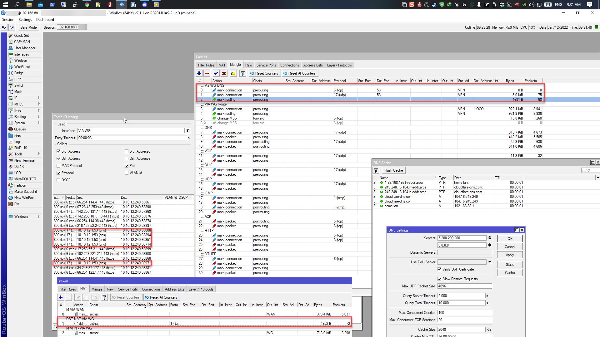

So this is an update.
As I was Missed the PMTUD I also Needed to use DOH to bypass the DNS filtering and as CF does not have any AS in this region the latency was F up. so I decided to not use the DOH in the Client MT and move the DNS queries to the WG peer.
mangle
/ip firewall mangle
add action=mark-connection chain=prerouting comment="VIA WG DNS" dst-port=53 new-connection-mark=via-wg-dns passthrough=yes protocol=tcp src-address-list=VPN
add action=mark-connection chain=prerouting dst-port=53 new-connection-mark=via-wg-dns passthrough=yes protocol=udp src-address-list=VPN
add action=mark-routing chain=prerouting connection-mark=via-wg-dns new-routing-mark=via-wg passthrough=no
add action=mark-connection chain=prerouting comment="VIA WG Route" dst-address-list=!LOCO new-connection-mark=via-wg passthrough=yes src-address-list=VPN
add action=mark-routing chain=prerouting connection-mark=via-wg new-routing-mark=via-wg passthrough=no src-address-list=VPN
add action=change-mss chain=forward connection-mark=via-wg new-mss=clamp-to-pmtu passthrough=yes protocol=tcp tcp-flags=syn
NAT
add action=masquerade chain=srcnat comment="M VIA WAN" ipsec-policy=out,none out-interface-list=WAN
add action=src-nat chain=srcnat comment="SRC-NAT Modem" dst-address=192.168.1.1 out-interface-list=DSL to-addresses=192.168.1.2
add action=src-nat chain=srcnat comment="SRC-NAT VPN - VIA WG" out-interface-list=WG to-addresses=10.10.12.240
add action=dst-nat chain=dstnat comment="DST-NAT VIA WG" connection-mark=via-wg-dns src-address-list=VPN to-addresses=10.10.12.1
address-list
/ip firewall address-list
add address=192.168.88.3 list=VPN
add address=192.168.88.2 disabled=yes list=VPN
add address=192.168.88.0/24 list=LOCO

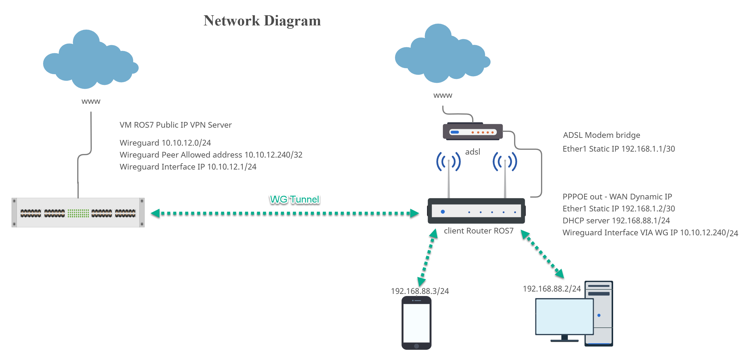

Without a network diagram and a clearer description of what was being done, I have no clue what the thread is about.
For example, I accessed Router A, with a wireguard tunnel from the iphone, I then entered a different tunnel to Router B for internet.
( One might say, why not just Tunnel from iphone direct to Router B, but what if Router B cannot act as a server - and thus Router B connects to Router A, and then is available for access )
Thanks for the diagram!
Q1: so you want the Iphone to go out the SERVER WANIP for internet??
Q2: Is the wireguard interface the same one for both iphone and Server - from the perspective of the MT router (two peers)
( one wg interface in use or two?, either way there is a solution so its up to you)
A1
so incoming traffic that the destination is not 192.168.88.0/24 from the source address, address-list=VPN will pass through the WG tunnel. any DNS traffic from address-list=VPN will pass through the WG tunnel.
A2
There is only one WG peer at the Client MT for this tunnel. The interface/Peer name is VIA WG.
There is another WG peer for another site-to-site Tunnel, WG STS is not related to this topic.
Your speaking a foreign language. I can never understand people who try to mix requirements and config.
I could care less about source and address lists.
See how I put into clear simple terms. Iphone user needs access to internet via WG interface at MT device.
Now you try… what are the user requirements.…
