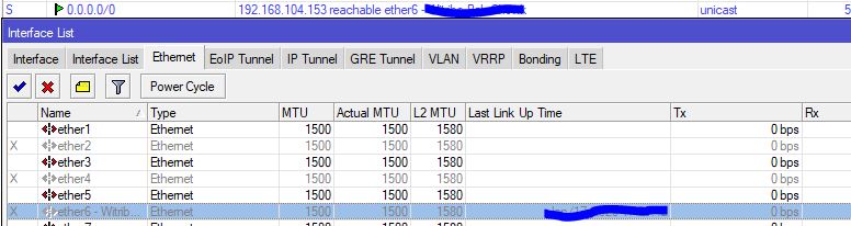

A snapshot is attached for interface scenario.
That route, although it says reachable via ether6, will not be used by the router as the route is not “Active”
What you seeing might be a Winbox refresh thing, do you see the same when doing a /ip route print in cli?
Yes, you are right because I deliberately chose inactive route to show the result.
But let me make it clear to you that if I had done it with with an active route it would have caused the same effect and I had faced downtime in the result… Which have happened multiple times.
