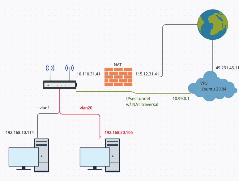

I need help with VPN configuration, I tried everything I found online but nothing seems to fit my scenario.
Let assume my network looks like below*:

I can access VPS at 10.99.0.1 from any computer in my network I also can reach any host in my home network from the VPS. I use it to expose local services to Internet because my ISP put me behind NAT.
What I’d like to have is:
  • the 192.168.10.0/24 network has to be connected with VPS as site-to-site tunnel as it is now
  • all Internet traffic from 192.168.20.0/24 must be routed via VPS
I it even possible without making two tunnels?
I tried marking packets and adding static route. It doesn’t work, because 10.99.0.1 is unreachable.
/ip firewall mangle
add action=mark-routing chain=prerouting comment="mark packets to be routed through IPSEC" new-routing-mark=myvps passthrough=yes src-address=192.168.20.0/24
add disabled=yes distance=1 gateway=10.99.0.1 routing-mark=myvps
I imagine adding GRE or IP tunnel on top of the IPsec tunnel would allow routing, right? But could I omit the extra overhead? Also from what I understand IPsec in tunnel mode is actually using IP tunnel underneath, and I cannot use transport mode because I’m behind NAT, am I right? Wouldn’t VTI (requested since 2012: Feature Request: IPSEC Improvements) solve my issue?
