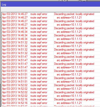

Please I have been seeing this error message on some of my routers:
Route OSPF error: Discarding packets: locally originated src-address=10.x.x.x (one of the routers IP address)
Please what could be the cause of the problem.

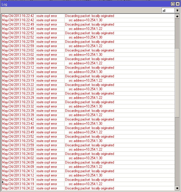

Anything new on this? 8 lines of ospf errors per 3 seconds in log. Nothing changed no new routers or rules added.
