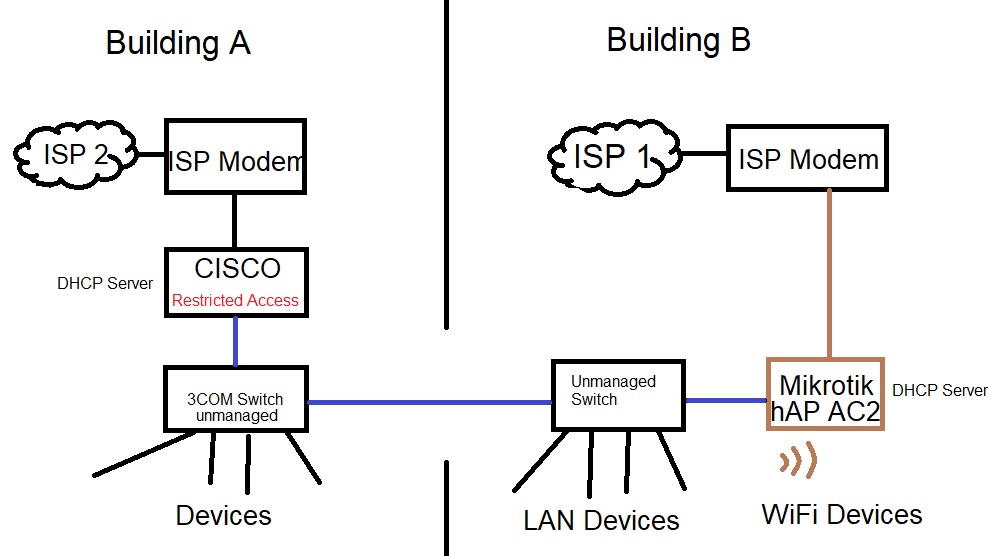

So this Mikrotik is located in Building B which the main internet source come from ISP 1, distributed to connected devices via WiFi.
In the same time, I also have the main network using LAN from Building A which the main internet source come from ISP 2, go through firewall CISCO (which I don’t have access as it was setup by HQ and not possible for me to access it), go to switch and distributed to connected devices via LAN.
The color BLUE represent DHCP IP (192.168.0.X) from CISCO and BROWN represent DHCP IP from hAP AC2 (172.17.1.X).
As you can see the setup above, I use the ISP 1 for the main source of the internet and if it was down, it will automatically switch to ISP 2 which come from building A network.
Now the problem I have, in May the network run normal. My devices with IP range 172.17.1.X can access server which has IP range 192.168.0.X (for example 192.168.0.100), and I can switch the internet source using ISP 2 by disable setup route with distance=1. But recently when I tried to disable route with distance=1, I lost access to both local 192.168.0.X and internet access from ISP 2. And today is getting worse. It said reachable but I tried to ping by command prompt (Windows) and terminal (WinBox) both get request time out.
Please help if this is a bug or I did some mistake in the config but got lucky to have them running well.
Update: I tried change ether 2 to ether 5 can run well. Any idea how this happen? I also have tried to change the MAC Address of ether 2 just in case it got blocked from CISCO, but still can’t work
