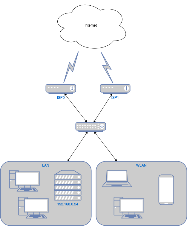

Howdy! I’ve got a setup similar to the attached simplified diagram. Two ISPs with failover, LAN and WLAN (although WLAN part is not relevant here). Mikrotik sits between local networks and both ISPs. What I need to achieve is that specific traffic, namely HTTPS (443/tcp) to the internet, from LAN host with IP 192.168.0.24 on the diagram, is always routed through ISP1, even if everything else (including other traffic from the same host) goes through the default WAN interface (ISP0 as long as it is up). The two WAN connections and failover, using recursive routes works perfectly fine but I can’t make it the setup to route HTTPS traffic from said host to internet always over ISP1. Tried to follow the thread here:

Here is what does not work (“WAN0” is the “ISP1” on the diagram), loosely based on:
https://help.mikrotik.com/docs/display/ROS/Firewall+Marking#FirewallMarking-DetailedSectionOverview.1
The idea being that the situation is similar but instead of marking the whole LAN subnet
src-address=192.168.1.0/24
only a single host with additional conditions could be used to achieve the same (forcing traffic through specific gateway/ISP):
dst-address-list=!not_public_ip dst-port=443  protocol=tcp src-address=192.168.0.24

the only issue is one LAN member that needs to go out WAN1 regardless for port 443 traffic.
I am thinking you only need one mangle rule for that traffic ( and associated table and extra IP route )
If anything the firewall rules look messy and may be part of the problem, hard to say without seeing the full config.
The dual WAN is only for
a) failover
b) the tcp/443 traffic from (currently only) this one internal host
this means that whatever traffic from the outside is not important as if the main WAN fails, the traffic requiring DNS lookup to main WAN IP will fail anyway, and traffic not requiring DNS will go through backup WAN. The host in question also does not expose the 443 port. It is only for traffic originating from this host - it needs to pull regularly in large amount of data
That’s what I thought too, based on the doc I linked to and a few other sources and that’s what I did but the moment those three are enabled, the host can no longer reach the data sources.

(1) All your DST NAT rules are missing the in-interface-list=WAN part of the rule ( dynamic ) or dst-address (static WANIP).
(2) why this duplicate nat rule..?
/ip firewall nat add action=dst-nat chain=dstnat dst-port=6669 protocol=tcp to-addresses=192.168.0.24
/ip firewall nat add action=dst-nat chain=dstnat dst-port=6669 protocol=udp to-addresses=192.168.0.24 to-ports=6669
(3) What is the purpose of this dst nat rule… functionally speaking what does it do? → dont need to know exactly what its used for…
/ip firewall nat add action=src-nat chain=srcnat protocol=tcp src-address=192.168.0.24 src-port=25 to-addresses=<external_ip> to-ports=25
(4) Dont understand your IP routes.
For simple primary failover should be like… (single recursive to make sure connectivity past the ISP is achieved (good practice).
Nothing more complicated…
The only additional route is for the mangled connection!
add check-gateway=ping distance=3 dst-address=0.0.0.0/0 gateway=1.0.0.1 scope=10 target-scope=12
add distance=3 dst-address=1.0.0.1/32 gateway=PrimaryISP-gatewayIP scope=11 target-scope=11
add comment=SecondaryISP distance=10 dst-address=0.0.0.0/0 gateway=SecondaryISP-gatewayIP scope=10 target-scope=30
add dst-address=0.0.0.0/0 gateway=SecondaryISP-gatewayIP routing-table=useSecondary
Assuming:
/ip table
add fib name=useSecondary
/ip mangle
add chain=prerouting action= mark-connection connection-mark=no-mark
in-interface-list=LAN src-address=192.168.0.24 dst-port=443
new-connection-mark=https-conn passthrough=yes
add chain=prerouting action=mark-route connection-mark=https-conn
new-routing-mark=useSecondary passthrough=yes
Note: The connection marks is not strictly needed as one could go straight to the routing mark,
but I use the no-mark for other reasons (aka fastrack rule see below)
Where I may miss the mark is that your server does HTTPS port 443 to other local users ??? If so, then we need to adjust it further refined so we dont capture that traffic by accident…
by adding dst-address-type=!local to the first rule…
(5) Firewall filter rules and address lists… - simplify StART WITH THIS and add more later if there are issues,…
/ip firewall address-list { set static dhcp leases }
add address=AdminIP-1 list=TRUSTED comment=“admin desktop”
add address=AdminIP-2 list=TRUSTED comment=“admin laptop”
add address=AdminIP-3 list=TRUSTED comment=“admin smartphone”
{Input Chain}
add action=accept chain=input comment=“defconf: accept established,related,untracked” connection-state=established,related,untracked
add action=drop chain=input comment=“defconf: drop invalid” connection-state=invalid
add action=accept chain=input comment=“defconf: accept ICMP” protocol=icmp
add action=accept chain=input comment=“defconf: accept to local loopback (for CAPsMAN)” dst-address=127.0.0.1
add action=accept chain=input comment=“admin via SSH - crappy choice use Wireguard instead” dst-port=22 protocol=tcp
add action=accept chain=input in-interface-list=lan_and_wlan src-address-list=TRUSTED
add action=accept chain=input comment=“Allow LAN DNS queries-UDP & NTP”
dst-port=53,123 in-interface-list=lan_and_wlan protocol=udp
add action=accept chain=input comment=“Allow LAN DNS queries - TCP”
dst-port=53 in-interface-list=lan_and_wlan protocol=tcp
add action=drop chain=input comment=“drop all else”
{forward chain}
add action=accept chain=forward comment=“defconf: accept in ipsec policy” ipsec-policy=in,ipsec
add action=accept chain=forward comment=“defconf: accept out ipsec policy” ipsec-policy=out,ipsec
add action=fasttrack-connection chain=forward comment=“defconf: fasttrack” connection-state=established,related connection-mark=no-mark
add action=accept chain=forward comment=“defconf: accept established,related, untracked” connection-state=established,related,untracked
add action=drop chain=forward comment=“defconf: drop invalid” connection-state=invalid
add action=accept chain=forward comment=“allow internet traffic” in-interface-list=lan_and_wlan out-interface-list=WAN
add action=accept chain=forward comment=“port forwarding” connection-nat-state=dstnat
add action=drop chain=forward comment=“drop all else”
Note: Any traffic required not covered that is required above, add where the ********* are located.
Examples could be all users (both wlan and bridge) to shared printer or Admin IP or TRUSTED list to all subnets etc…
Final comment, if you didnt notice it in the config, suggest you use wireguard to access router remotely vice SSH and thus no worries about port 22 abuse.
Even still as a backup its not so bad but why on earth are you using the common default port. Do it on 2222 for example ???
I lied, final final comment, you should insist all your users coming into the servers provide you with either their:
a. fixed static WANIP OR if they dont have that
b. their dynamic IP via a DYNDNS service, there are many that are free so their is no excuse not to have one. You put these into a firewall address list and the mT router will resolve them.
This provides a better level of server security and also makes all the ports invisible on scans vice the normal visible but closed on scans.
I guess nobody ever noticed because it generally works. To my understanding dst-address is not defined because it uses whatever the default at the moment is. in-interface-list could be defined though. Do I understand correctly that adding this can improve performance a tiny bit, right?
I “inherited” this setup so I may not know all the details but a) it’s different protocol so I take it needs both tcp and udp. Why the first one doesn’t have to-ports like all remaining ones I don’t know. Does it take the same port (as dst-port) by default?
Not a secret. The server in question sends e-mail out. The rule “src-nats” its IP into specific one of the five external IPs, used only for e-mail in a DMARC compliant way (SPF specified, signed, etc.). So in other words the rule is supposed to make the SMTP connections come out from selected IP
It is not more complicated, with the exception that it uses two recursives because there are two monitored IPs in case one is unreachable for reasons different than the ISP fault.
And that’s how it is. Two recursive routes for PrimaryISP:
/ip route add disabled=no distance=1 dst-address=<monitored_ip0> gateway=pppoe-wan2 pref-src="" routing-table=main suppress-hw-offload=no target-scope=31
/ip route add disabled=no distance=2 dst-address=<monitored_ip1> gateway=pppoe-wan2 pref-src="" routing-table=main suppress-hw-offload=no target-scope=31
/ip route add check-gateway=ping disabled=no distance=1 dst-address=0.0.0.0/0 gateway=<monitored_ip0> pref-src="" routing-table=main scope=30 suppress-hw-offload=no target-scope=32
/ip route add check-gateway=ping disabled=no distance=2 dst-address=0.0.0.0/0 gateway=<monitored_ip1> pref-src="" routing-table=main scope=30 suppress-hw-offload=no target-scope=32
One default for SecondaryISP:
/ip route add disabled=no distance=5 dst-address=0.0.0.0/0 gateway=<wan0_gw_ip>%sfp1-wan0 pref-src="" routing-table=main suppress-hw-offload=no
And the only additional route is for the mangled (SecondaryISP) connection that I try to make work:
/ip route add disabled=no distance=5 dst-address=0.0.0.0/0 gateway=<wan0_gw_ip>%sfp1-wan0 pref-src="" routing-table=useWAN0 scope=30 suppress-hw-offload=no target-scope=10
It does. Actually it serves 443 only internally
Again - that’ how (I believe) this is done:
/ip firewall mangle add action=mark-routing chain=prerouting dst-address-list=!not_public_ip dst-port=443 new-routing-mark=useWAN0 passthrough=yes protocol=tcp src-address=192.168.0.24
Please note the
Although - yes - it could use address-type
I appreciate your input and most probably shall implement your suggestions over time. Just for the current urgent problem I still couldn’t infer from the above why I can’t make the 192.168.0.24 server to have outgoing 443 traffic routed through “Secondary” ISP regardless of the state of primary one. I don’t do the connection marking but you mentioned (the same what I thought) that it is not strictly necessary. I didn’t have the in-interface-list but adding it doesn’t change anything. So what else am I missing or doing wrong?
  1. In terms of any config rule its best to remove ambiguity.
  2. My bad I should have noticed it was two diff protocols…
  3. I was only aware of 2 WANIps, not sure what you mean by 5 external IPs… if it aint local on the router how do you sourcenat to it ???
  4. Okay got it two recursives…
  5. Okay so thats straight, the server originates 443 traffic out to the NET and acts as a server for 443 locally.
    I dont like the formulation of your mangling setup…
Try mimmicking my mangling setup and see if that is successful…
/ip table
/ip mangle
in-interface-list=LAN src-address=192.168.0.24 dst-port=443 dst-address-type=!local
There are two WAN connections but the “Secondary ISP” aka “WAN0” in the historical naming of this setup is not a single IP but a three bit subnet:
/ip address add address=<subnet_ip_address_0>/29 interface=sfp1-wan0 network=<network_ip>
/ip address add address=<subnet_ip_address_1>/29 interface=sfp1-wan0 network=<network_ip>
/ip address add address=<subnet_ip_address_2>/29 interface=sfp1-wan0 network=<network_ip>
/ip address add address=<subnet_ip_address_3>/29 interface=sfp1-wan0 network=<network_ip>
/ip address add address=<subnet_ip_address_4>/29 interface=sfp1-wan0 network=<network_ip>
The current primary ISP gives only a single IP over PPPoE so it’s not included in the statically assigned addresses above. Altogether there are six external IPs. One on “WAN2” and five on “WAN0”. One of those IP addresses is “mail.”
This is RouterOS 7 so I can’t exactly reuse your mangling setup but here’s as close as I could
/routing table
add disabled=no fib name=useWAN0
/ip firewall mangle
add action=mark-connection chain=prerouting connection-mark=no-mark dst-address-type=!local dst-port=443 \
    in-interface-list=lan new-connection-mark=https-conn passthrough=yes protocol=tcp src-address=192.168.0.24
add action=mark-routing chain=prerouting connection-mark=https-conn new-routing-mark=useWAN0 passthrough=yes
add comment="xtra d5 for useWAN0 table" disabled=no dst-address=0.0.0.0/0 gateway=<wan0_gw_ip>%sfp1-wan0 pref-src="" routing-table=useWAN0 suppress-hw-offload=no
No change. I start to wonder whether these two are enough
add action=fasttrack-connection chain=forward comment="FastTrack established and related connections" connection-mark=no-mark connection-state=established,related hw-offload=yes
add action=accept chain=forward comment="Accept already established and related connections" connection-state=established,related
but they should, shouldn’t they?
Yes those rules all look good…??
Are you saying that all port 443 traffic ORIGINATING/starting at the server is still going out wan0, instead of wan1 ??
No, when I activate those or my previous variants (with or without connection marking) then the server stops communicating to the outside over 443
Hmm, okay but remember there is no INCOMING traffic originated that hits that server at port 443.
Its strictly the server initiating traffic out port 443, to what I dont know.
Is the outgoing traffic heading out WAN1 and the problem is return traffic is not making it back???
Finally is the problematic WAN (secondary), the one with multiple external IP addresses??
It’s only initiated from the inside and nothing 443 should com from the outside. So… I was wondering whether those “established, related” filter rules were enough. It’s TCP so.. they should?
If you could answer the questions it would be helpful :slight_smile:
It makes no sense to state, it only originates out port 443, if it does then there has to be return traffic.
SO, does traffic actually leave the router on port 443 on the secondary WAN Yes/No ?
Does the return traffic get through Yes/NO ?
Is the problematic Secondary wan the one with multiple options for IP address yes/no?
