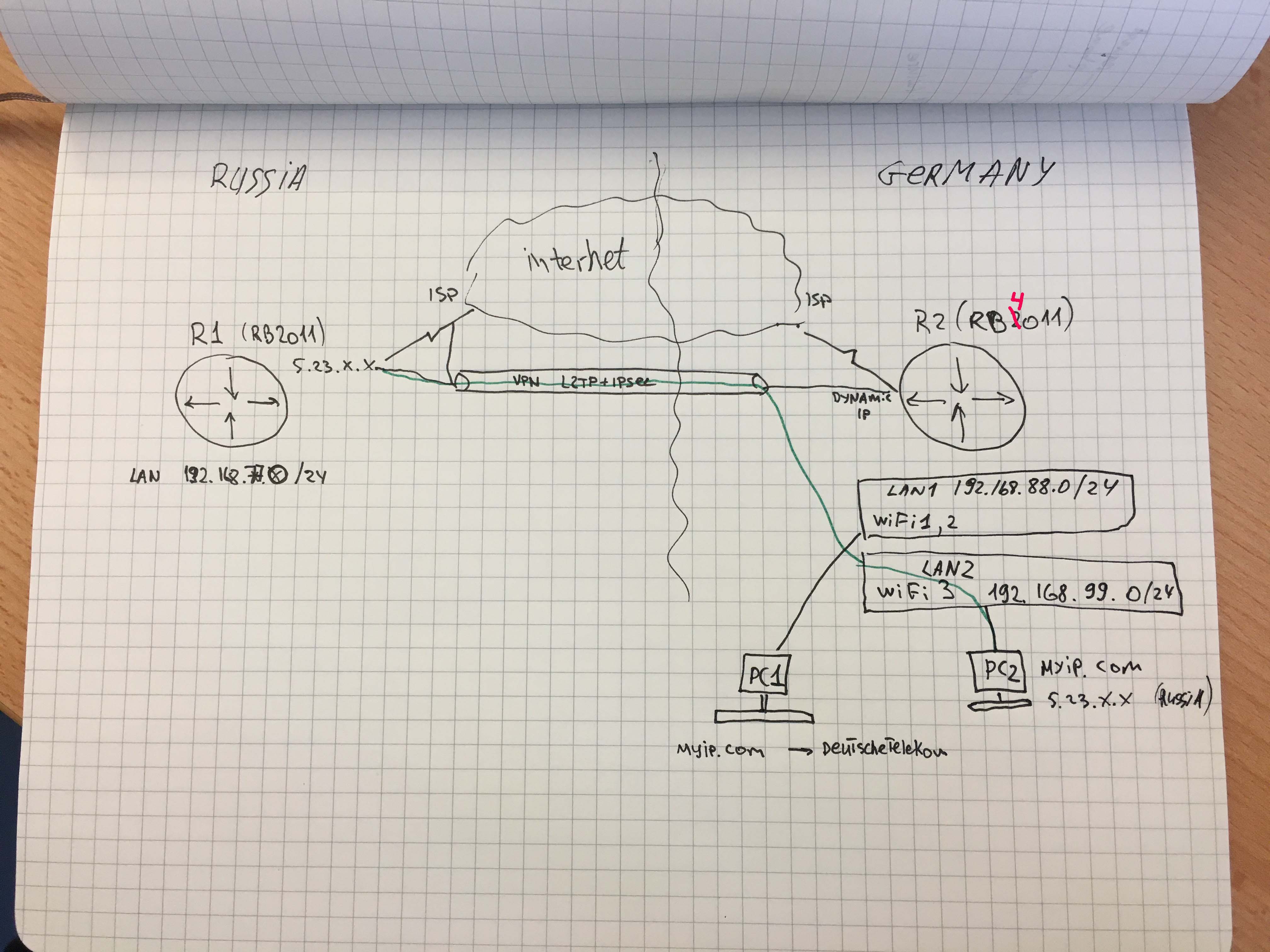

I understand, thank you, I’ve corrected the question. I will provide image that will help me to explain what i want to achive

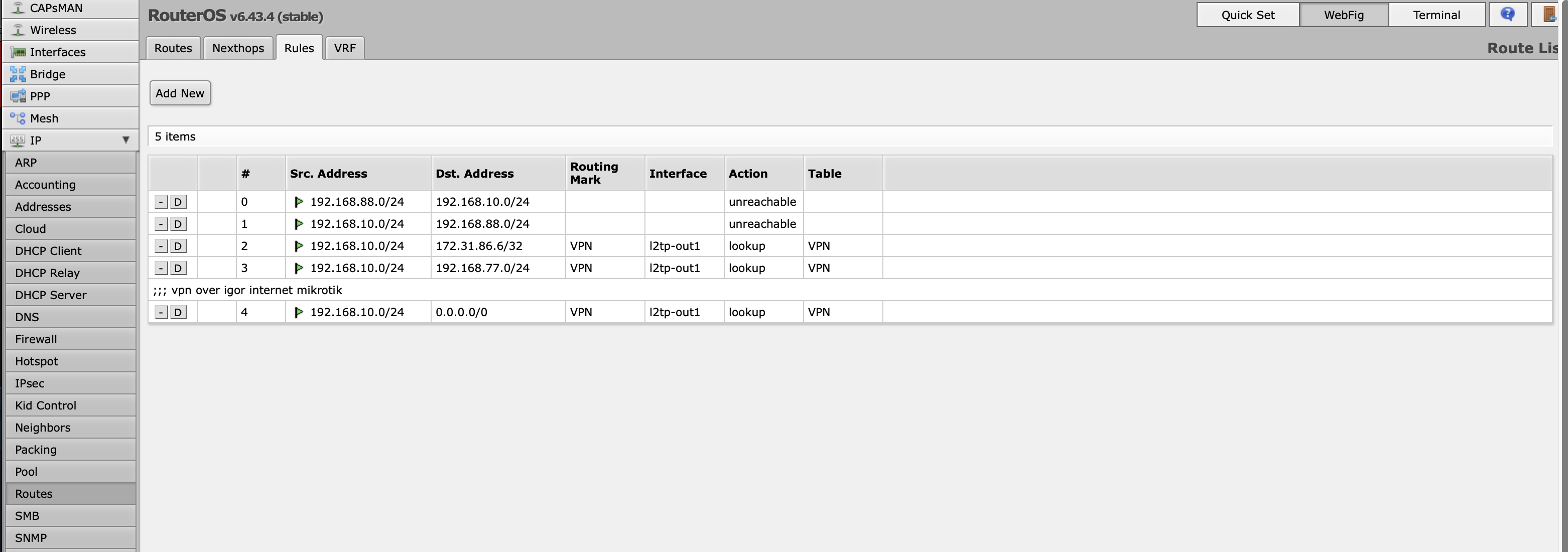

After that you need to configure your policy routing rules, under IP route rules, when the src address is the computer’s IP address to use the Table " VPN " and then in the IP routes you need a a record with gateway the remote VPN router and routing mark the " VPN " ..
yes I have setup L2TP tunnel, it works fine. Now i need to route all trafic from LAN2 to that VPN. Not only from PC2, but from all LAN2.
p.s. LAN1 should still use old gateway and goes to internet from my German provider.

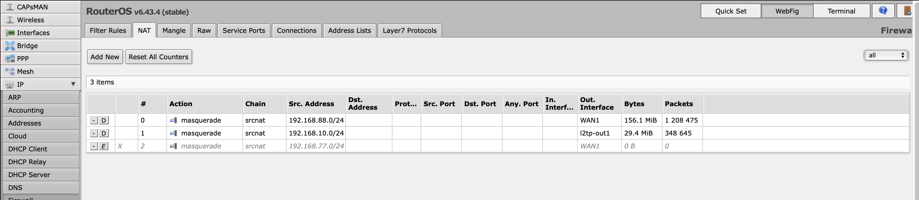

As said earlier the steps are routing rules then routes also masquerade the LT2P interface, forgot to mention that before…

Under ip route rules you can select the interface you want, i have not tested with interface name but only with IP, but i guess it will work too…

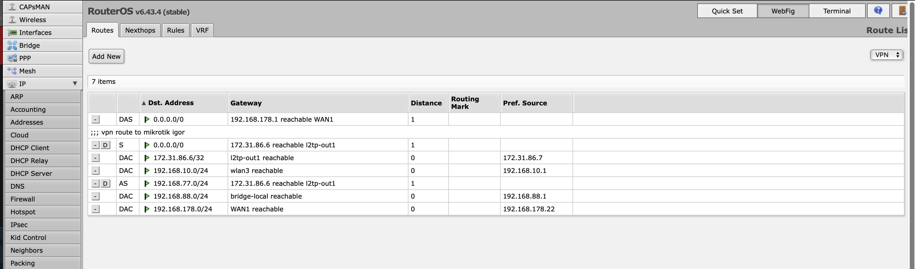

super, now i can access to remote subnet from wlan3. but i still cant access internet over that vpn. from mobile phone its working fine, and my ip changes to ip of rb2011.
where to look now?

this is on rb4011 (local)
wlan3 192.168.10.0/24
  1. In the ip route rules remove the interface value on your last rule… Also you dont need both routing mark and Table values, just set Table to “VPN”…
  2. In the ip routes, in the second rule, you must set the routing mark to “VPN”
thank you! it works superb
