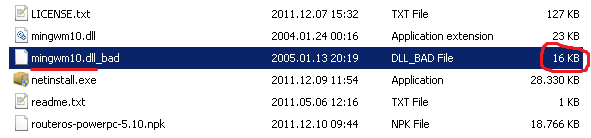

OK i have found the problem - it was the mingwm10.dll file version.
The first one i was using was downloaded from http://www.dll-files.com/mingwm10.zip?0WEfSDULgV
I have downloaded new one from http://download-free.nodevice.com/cc0d3fffad948d1ab968e05795252e55 and system image was tranferred to the router. Horay :slight_smile:
So if someone will have similar problem try to get another mingwm10.dll file :slight_smile:

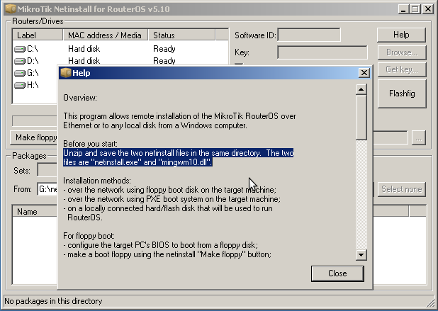

Well, after extracting net install, and executing it i have clicked Help button. There were notice “Before you start:” about mingw10.dll, it tells that this dll must be in the same directory as netinstall.exe file.
That dll wasn’t included in zip file, so i have downloaded it from internet :confused: .
