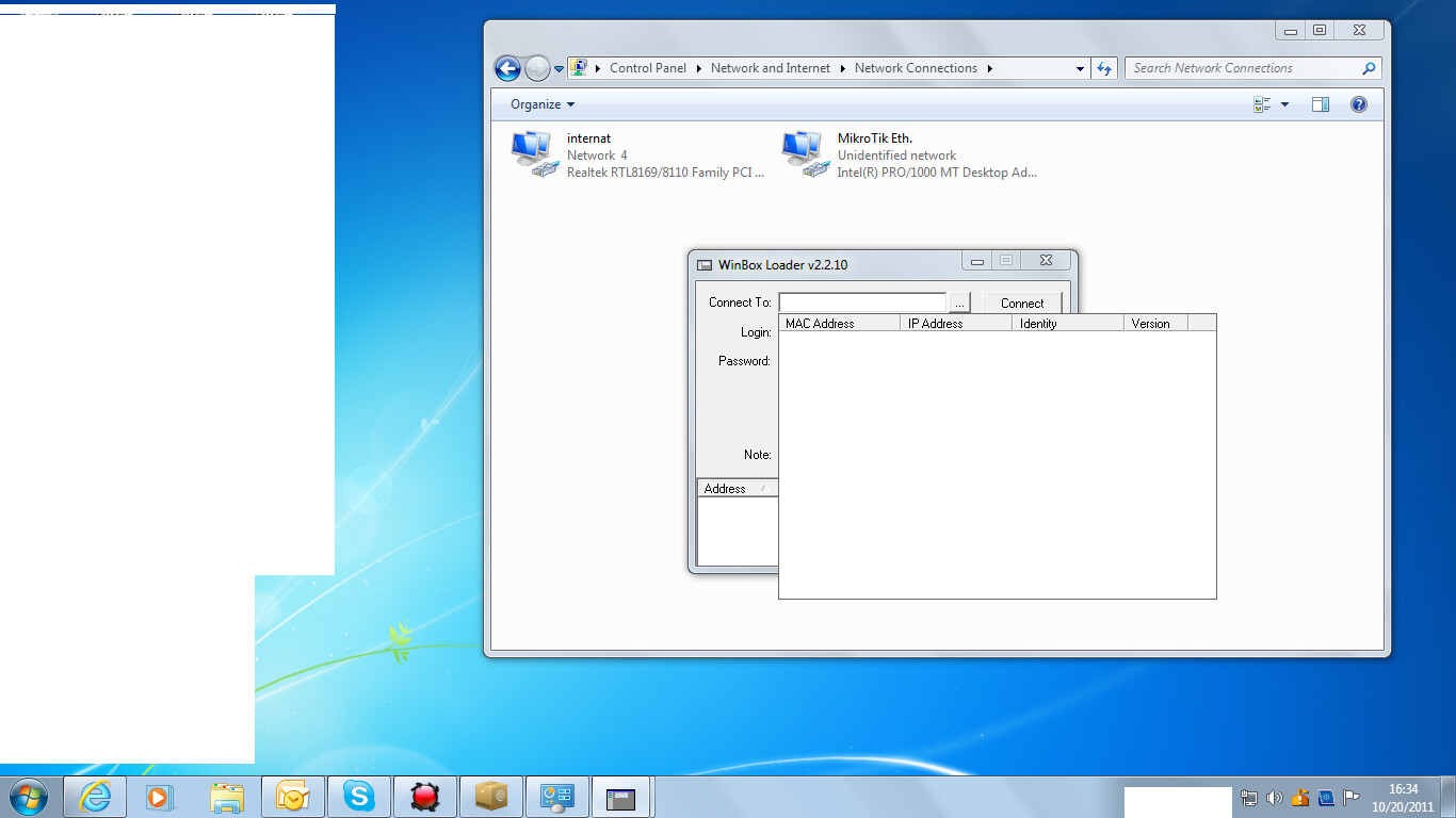

i have RB 750G and i can not scane it in Winbox ,router is reboot properly… and LED on in Eth1, i change Eth port also but same problem, what is problem… in 750G…

when i scane it…eth port light is blinking…but not scane…there is posible…problem in OS??
