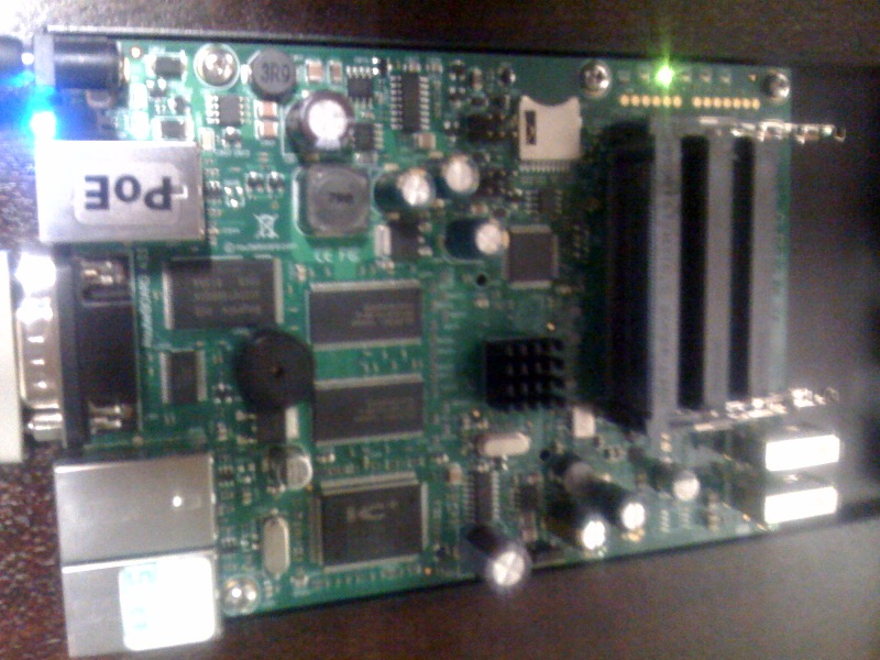

I have a new RB 433 UAH that i upgrade the OS and after that it does not boot up any more.
Try with POE and different power supply to make sure power was not the problem.

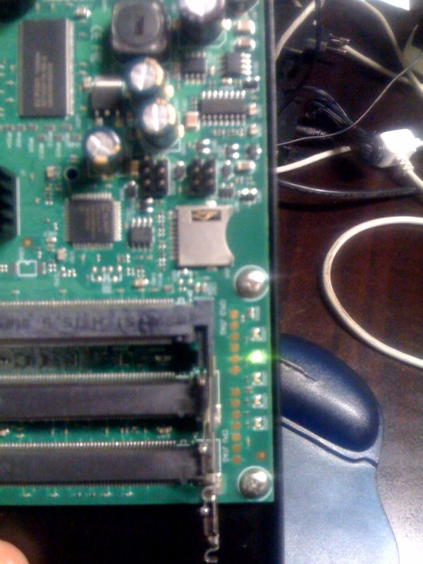

The RB come up the light shine on the network interfaces but no beep sound come up and then the LED LD504 come on and that is it nothing happen after it.
I also try serial port and nothing :frowning:
I being reading for 2 days and i don’t see any way that i can recover this hardware.
Please i really want get this RB up and running .
This is some pic of the board when is stuck.
