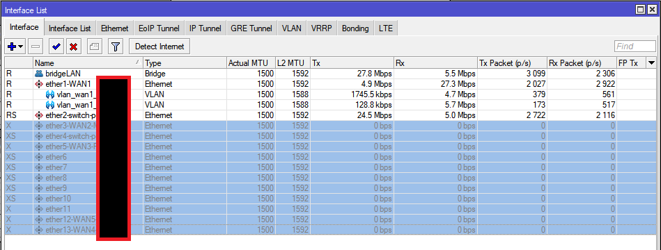

I’m having an issue with an RB1100AHx4 @ v6.48.6
Traffic dies after exactly 10 minutes, for about 10 seconds maybe less (see attachment)

Started recording a second before it dies, this is what it does, always at the exact same time X:10 minutes (like 1:10, 1:20, 1:30)
Everything dies and comes up between 5 and 10 seconds.
i even tried to disable most of the switches and interfaces, with no luck

edit: while there are switch setting of the vlan-id=0, that may be normal in V6 - just never see it in V7.
is there anything i should see there or you just posted the config on
ive just disabled all ports and its still doing it... even disabled the vlans
CPU usage quite high for the amount of traffic passing over it. did you try to login using mac-telnet to see if it still disconnects you?
Yeah, I just posted your config since it is easier to read inline. The only thing that jumps out is I’d avoid using “masquerade” in the /ip/firewall/nat, if you can.
In older V6, there is some interactions masquerade and when the route table changes (which there would be with BGP). I’ve been using V7 for while, so can’t recall all the specific ending. But at some point it used be that “is every 10 minutes routing table is flushed for security reasons (to avoid possible DoS attacks)”, see https://wiki.mikrotik.com/wiki/ECMP_load_balancing_with_masquerade that talks about this in the in context of ECMP (but imagine all connection tracking).
ive got several wans with load balance, i cant remove the masquerade, or how would i do it?
Src-nat, one for each WAN interface, with explicitly set to-addresses (appropriate for each individual WAN interface).
Agree with @mkx - “action=src-nat” - all your WANs look to have fixed IPs.
I still have a 2017 MUM presentation burned in my head: “My ‘holy war’ against masquerade” from one of the MT guys, see https://www.youtube.com/watch?v=3LmQYIQ5RoA&t=1187s that might explain this better than I can. FWIW, V7 acts different here since there is no route cache.
deleted all masquerades
