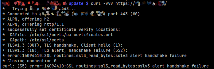

Still have 443 port opened and accepting connections. Checked with curl:

  1. When we try curl we have no meaningful answer due to tls handshake failure. When we do curl http://:443 , we do not have any answer (“Empty reply from server”).

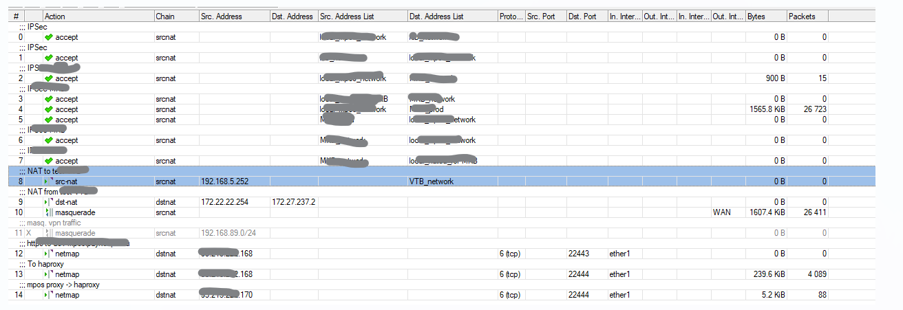

  3. We’ve checked forwaring rules , only have forwarding for several explicit external IPs and incoming ports like 22443:

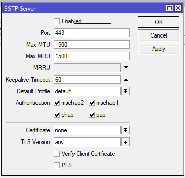

But in winbox SSTP server show as disabled:
My bad, checked it on another winbox.
SSTP was enabled. I’ve disabled it and nmap stopped showing port as open, curl also started refusing connections.

But you got “enabled=yes” for that SSTP according to the CLI config and I would trust that more than winbox.
You could try to enable www-ssl and set that to a different port like 8443 or such and login using https://:8443 or whatever port you select and see what webfig tells you about this setting in the GUI?
Another thing to test is to (if possible) reboot the device and see if winbox fixes its display if this feature is enabled or not, or connect from another mgmt-client.
Before you do it would be interresting if you can set this feature to “enabled=no” and then do a new portscan to see if the 443/TCP goes away from the results?
