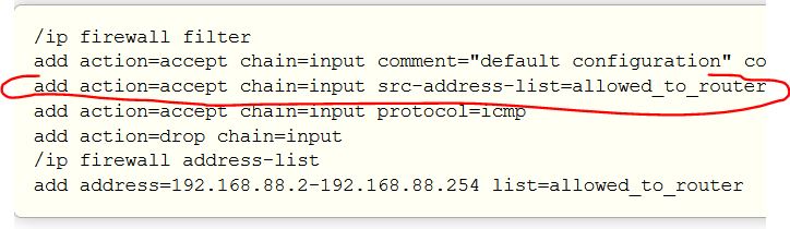

Hello specialists!
Which of the rolls will work better?
The first option specifies an in-interface-list (all except WAN)
add action=accept chain=input comment="Allow access to router from known network" in-interface-list=!WAN \ src-address=192.168.88.0/24
In the second - only subnets and no interface are specified.
add action=accept chain=input comment="Allow access to router from known network" \ src-address=192.168.88.0/24
In the third - address lists without interface.
add action=accept chain=input src-address-list=allowed_to_router
/ip firewall address-list
add address=192.168.88.2-192.168.88.254 list=allowed_to_router
How is it more correct? Do I need to specify an interface? Better to specify the entire subnet / 24 or a specific range? Does it somehow affect access performance, security?
Thanks!
I would combine all this into one single rule to make sure both conditions are met simultaneously!
Using source address (or source address list) + input interface (or input interface list) in one rule.
If you have different IP ranges on different interfaces, create for each combo on accept rule and then
at the end you have the final drop all rule.
it is good/recommended/necessary to be as restrictive as possible on the input chain.

Thanks WeWiNet! Then can I safely use the version with source address(list) + input interface(list) ?
Yes, that is already better…
But “save” is a big word. There is much more to that to be save.
Have a look here: https://wiki.mikrotik.com/wiki/Manual:Securing_Your_Router
Once you did all that, then you start to be save!

Here the feedback on your post:
1.) The example you show uses “source-address-list” . You can do use that, or directly the source-address.
If you only have one /24 address range you do not need a list.
An address list is needed/usefull if you have more IP subnets, like 192.168.88.0/24 + 192.168.100.0/24 for example.
Or individual IP addresses you want to select!
2.) It is always more exclusive (safe) to also add the interface or bridge or interface list from where you expect traffic to come + IP address in a filter rule!.
So keep the LAN AND the IP address.
basic rule is: only allow exactly what you want to allow!
You want to allow access from only LAN interfaces AND only specific IP address? → put both into the filter rule.
You think limiting access to router by IP address is enough and not locking the door twice? Only use the IP address.

I have no problem with the other firewall rules. My main question was - to access the router from the internal network subnet necessarily need to specify the interface? I realized that yes
Thank you so much for the answers!
