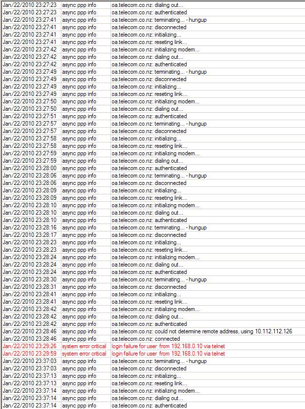

yes, I am using Radius server. I’m getting following log messages from RouterBoard and Radius server:
On RouterBoard
PPP connection terminating (hang up) then re-authenticating.

The four hour reset did not re occur last night but there was a period of half an hour where the PPP session kept dropping and the other router (other brand) next to this one was stable over the same period. I added a logging target with a topic of ‘radius’ and an action of ‘memory’ and got the log informations (please see attached file).
