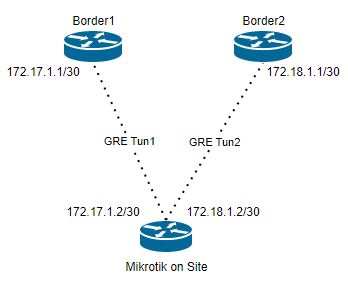

Mikrotik router on site is building GRE Tunnels with two border routers in Data-Center.
eBGP peering is established via this GRE Tunnels with each of two border routers in DC.
Two default routes are installed into routing table of Mikrotik router on site. Routes are received via eBGP.

When GRE Tunnel 1, which leads to Border1 and from which bgp peer default route is “active”, goes down second default route from Border2 does never become active. Even when first route from Border1 is withdrawn from routing table due to BGP peering is not “established” anymore and there is only one default route from Border2 leaft in routing table.
Default route from Border2 becomes active only if I disable and reanable Border2 bgp peer.

Make sure you have configured TTL=1 and proper “update source” (either 172.17.1.2/172.18.1.2 or the GRE interface name) as well.

TTL=1 is in place, “update source” is not needed as it is pure eBGP. There is no other options to sent packet with “source ip” different from GRE tunnel address.

Did you check that the BGP peer indeed goes down? The recommendations for TTL and update source I made are to make sure that the peer does not remain connected via another path. Update source in RouterOS is also used as the source address for the BGP peer connect. With these settings you are sure it can only connect the BGP peer over its own tunnel so the BGP connection is assured to go down when the tunnel goes down.
