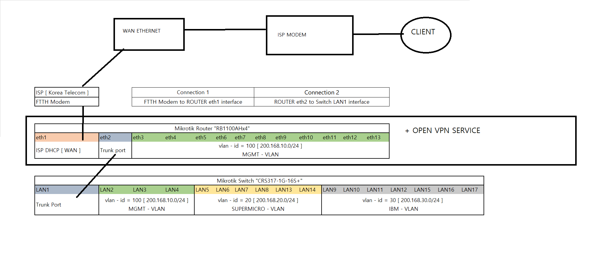

  • And I drew the system that I wanted. Please watch it.
IMAGE FILE : OPENVPN SYSTEM
Finally, I want VLAN and OPEN VPN to be able to communicate.

Such proof only proves that some layer in the whole arrangement doesn’t work, but you need to find out which one in particular.
My analytic steps would be the following:
  1. check on the client that the DNS name of the 1100AHx4 really resolves to the IP currently assigned to the 1100AHx4 (i.e. that the DDNS part of the task works properly)
  2. check that the UDP packets to port 1194 do reach ether1 of the 1100AHx4, using /tool sniffer or /tool torch which look at the incoming traffic before the firewall can eventually drop it. If the packets are not there, something on the route between the client and the server may block them.
  3. check that the firewall rule permitting packets towards UDP port 1194 counts packets - if it doesn’t, some rule before it shadows it (and either accepts or drops them, hard to say)
  4. only if all the steps above succeed, it makes sense to start logging the openvpn itself
First of all, I want to let you know today that ddns can communicate externally
Why communications are possible.
ip firewall filter rule
[cskeisa@Router]>/ip firewall filter add chain=input action=drop component="Drop" -> remove!
The ddns became an external communication, so I tried to connect to the client with OPENVPN.
Results : Failure

Please add back the drop rule to exactly the same place in the input chain of filter from where you have removed it, as by removing it you’ve permitted access to management of your router to the whole internet. I’ll write more when I get to PC, this is from mobile as it is urgent.
So I’ve had a look at /ip firewall filter in your configuration export, assuming that you’ve exported it after
My assumption is that the rule above was originally the last one in chain=input of your /ip firewall filter, and then you’ve just added the action=accept chain=input dst-port=1194 protocol=tcp rule without using place-before to insert if before that action=drop rule, so the result was that the OVPN packets got dropped before they could reach the permissive rule.
By removing that action=drop rule, you made all services of the RB1100AHx4 open to the world, except those protected by the very first rule in chain=input, which is the action=drop chain=input comment=“Drop FTP,SSH,Telnet from inbound” dst-port=21,22,23,139,445 protocol=tcp one. So http, winbox, api, api-ssl were open for everyone (as by default they are enabled and not restricted to a particular source address range, and there is no /ip service session in your configuration export which means that default settings are active). The reason is that packets which didn’t match any rule in their corresponding chain in /ip firewall filter are accepted.
A more detailed explanation of how the firewall works is e.g. here.
Last point to the firewall, the rule action=accept chain=input dst-port=1194 protocol=udp is useless because Mikrotik’s implementation of OpenVPN doesn’t support UDP as its transport protocol at all (UDP payload can be used).
I doubt that the duplicate packets are the reason why it doesn’t work. Your firewall with the “drop all input” rule in place doesn’t allow openvpn clients to establish new connections to the RB1100AHx4 because the dynamically created /interface ovpn-server is not a member of /interface list name=MGMT nor of /interface list name=VLAN because the /ppp profile name=OVPN doesn’t have an interface-list item to add the dynamically created /interface ovpn-server to the indicated interface list dynamically. But as it didn’t work even when the “drop all input” rule was not there, there must be some other reason on top of it.
So please issue the following command:
/system logging add topics=ovpn
Then try to connect the client, and once it connects or reports a failure, do /log print file=ovpn-log where topics~“ovpn”, and post here the resulting ovpn-log.txt file. If the client connects successfully, post here also the output of /interface ovpn-server print detail.
I added the firewall rule “chain=input action=drop” again.

Oh, and nothing was set in the interface ovpn-server.
I set it up after watching youtube, but now I feel very confused when I see what I have set up.
So I suggested.
I want you to let me know how to build openvpn correctly.
This is because I may be confused in the process of building vlan.
And I want you to know that I’m in the “novice” stage using mikrotik.

After checking the inter-vlan setting, I found that I use L3 for my router and L2 for my switch.
Therefore, the router will maintain and use L3 and the VPN will be considered to be used L3.
And the step I understand is to use inter-vlan as a Cisco device, so I don’t know much about mikrotik.
So I don’t know how to set up the firewall. If possible, I want you to tell me how to set it up and how to do it.
I just understand the OSI7 class and understand VLAN.
