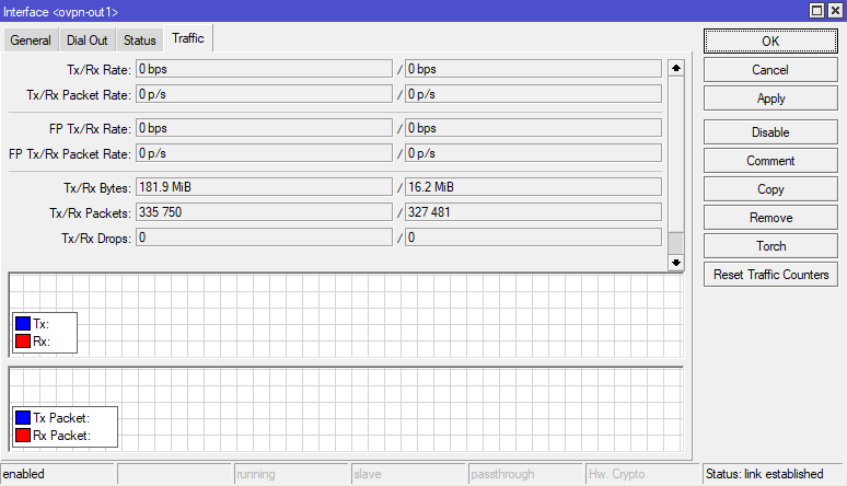

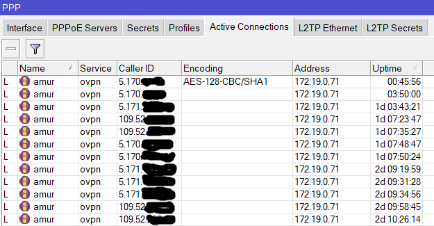

Dear Mickey,
I want update you about my issue. Please consider the user “amur” that running Mikrotik Router OS 7.8. I configured in it’s PPP profile an “idle timeout” of 20 seconds.
For the moment when a VPN goes down it reconnect correctly. For the moment I don’t have the issue that block definitely VPN connection. But I continue to monitor it.
In the screenshot attached you can see the “amur” VPN connection on server side. As you can see I have a lot of entry. The server doens’t close correctly the vpn connection whene it goes down. If in the profile I configure “only one” the VPN connection became impossible because for the server the user “amur” is already connected.
Nothing to do. I attach you also other screnshot of user “amur”.
As you can see when the problem occour it doesn’t retry to reconnect to openvpn server and the interface ovpn-out1 remain in NOT REGISTERED MODE (fig. 1) without ip address but if you see details it tell “link estabilished” (fig. 2).
In the log file I have no entry related to ovpn but if i manually disable and renable interface it immediatly reconnect to server (Fig. 3)
Any suggestions to resolve this issue without scripts?

I think this is a serious bug. The ovpn-out1 interface remain in “link estabilished” status also if in IP->FIREWALL->CONNECTIONS there isn’t a connection to vpn server.
