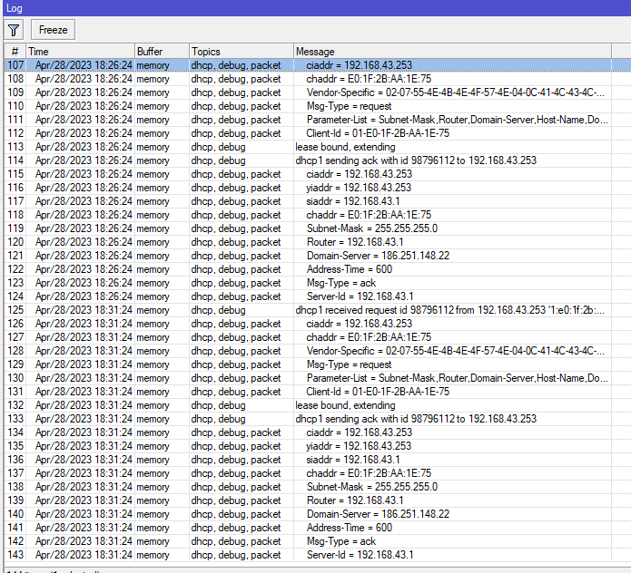

I need to send DHCP 43 Options to a dhcp server, but using Vendor Class ID to only send the option to the routers that match, but the type of router that i’m using does not send the VID to the server by default, i saw the changes in DHCP Matcher, and i’m wondering how can i use the matcher, since in the tests that i’ve done i had no sucess
DHCP Option 43 that the Router sends to the RouterBoard:
Vendor-Specific = 02-07-55-4E-4B-4E-4F-57-4E-04-0C-41-4C-43-4C-46-43-33-35-34-46-38-43-05-0C-33-46-45-34-39-32-33-36-42-44-41-41-06-0E-33-46-45-34-39-34-37-34-48-4A-49-4C-39-36-08-06-30
Has anyone had sucess in changing the pool that the device will use using the matcher? i tryed using the matcher with the HEX, and by plain text, no sucess.
0x02 0x07 UNKNOWN
0x04 0x0C ALCLFC354F8C
0x05 0x0C 3FE49236BDAA
0x06 0x0E 3FE49474HJIL96
0x08 0x06 0
