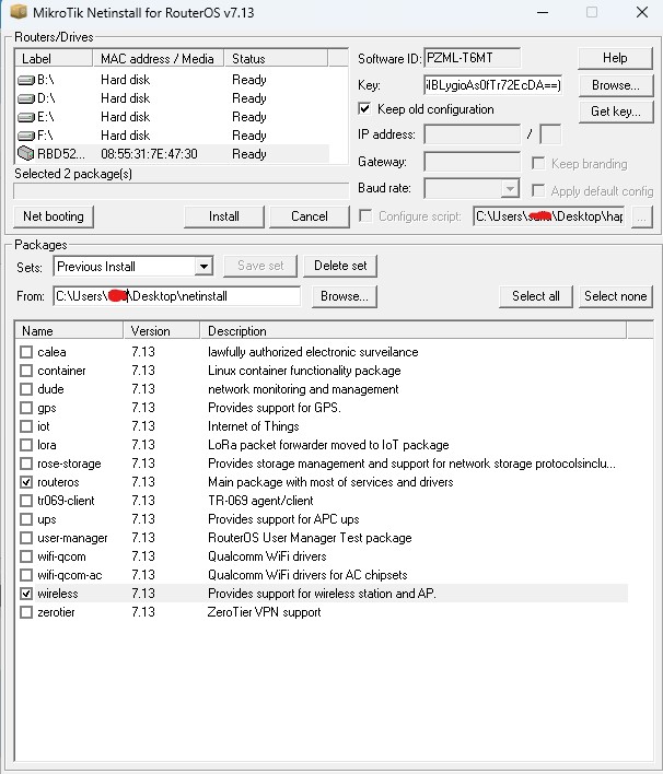

I am not able to see any Textual Config option. Can you please help me in this regard. Where can I export the existing configuration so that I can check what the user configured before hacking. Is that also possible to get the password of the users?
No, it is too late for all that.
You should have saved the backup and export files BEFORE this happened…
Now, the best thing is to netinstall, remove the checkmark for “keep old configuration”, and start over from defaults.

“The “Keep old configuration” process involves downloading the configuration database from the router, reinstalling the router (including disk formatting), and uploading the configuration files back to it. However, it’s important to note that this process solely applies to the configuration itself and does not impact the files, including databases like the User Manager database, Dude database, and others.”
https://help.mikrotik.com/docs/display/ROS/Netinstall#:~:text=The%20"Keep%20old,database%2C%20and%20others.
Maybe this is your last chance to regain access to your device again without losing your whole config.

Yes, you can get the config again but that will include your loss of access!
So not useful to do that.
The only thing that can be useful before netinstall is look around in the user interface if you can see things that were configured, and make note of them.
After the reinstall you can do these configs again.
