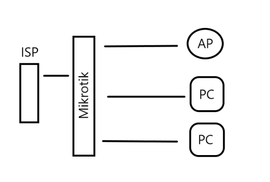

Hi, I have a RB5009 running RouterOS 7. I have an old Linksys router that I want to use as an AP.
My objective is to give the AP:
  • access to internet only
  • no access to other devices wired to the RB5009.
/ ------------> AP
ISP → RB5009 ----> PC
-—> PC
- → PC
In essence, I consider any device connected to AP wifi untrusted.
Question: How do I go about making this happen? Thank you in advance for your help.

From your picture I assume you AP is connected on the network part before your Mikrotik ?
In that case all communication from AP to Tik is already blocked, since the incoming port of your router (eth1) is considered WAN and that one is blocked by default in the firewall.
If you want to connect your AP to one of the ports on the RB, define that port in the interface list as WAN instead of LAN and remove it from the bridge.

my assumption is that the access point is also connected behind the router, also on the network as are the PCs…
@holvoetn: Sorry I just realised that the text diagram lost its formatting. I edit the original post with an image instead.

In general, this is only possible if the AP and its clients are on a different subnet.
If they are on the same subnet (layer2 connectivity) then layer3 firewall rules cannot prevent them from talking to each other.
Thus recommend using a different subnet for the AP etc…
Lets say you use 192.168.10.0/24 for the LAN and
192.168.50.0/24 for the AP…
then you only need to add one rule at the end…
add chain=forward action=drop in-interface=subnet WIFI out-interface=subnet LAN

I would add all PC ethernet ports to the bridge. The bridge is member of the LAN interface list
Ether1 is the WAN port by default (is member of the WAN interface list), and is not connected to the bridge
EtherX has your Linksys connected. That ethernet port is NOT on the bridge, but is member of the LAN interface list. (not the WAN interface list !)
Now you have 3 subnets to handle with the firewall.
The WAN interface list is securing your router, and the ether1 has a DHCP client by default. The WAN interface list is defined as having NAT in the firewall by default.
The LAN1 is the bridge. You have an IP address and DHCP server on the bridge. All PC’s are connected to ports of the bridge and are in the same subnet.
The LAN2 is etherX. EtherX port needs an IP address in another subnet (the subnet of the Linksys), different from LAN1
The @anav firewall rule will prevent communication between LAN1 and LAN2.

@bpwl: Thank you for describing the setup. The only additional thing is I dont want LAN2 to have communication with LAN1
@anav: Thank you and yes I’d like devices connected to AP to be able to talk to each other but not to devices connected to the router itself. I’d rather AP just go straight to WAN.
I pasted the full config as you requested. Please let me know the best way to achieve my objective:
1- shield and protect router from attacks/unauth access
2- shield devices wired to router from WAN but allow them to talk to each other (except AP)
3- provide WAN access only to AP and devices connected to it.
Side note: AP (old Linksys router) has its own DHCP and provides its own IP to devices connected to it wirelessly.

Whatever port is going to the AP, remove from the bridge.
Give the etherportX its own subnet, IP address IP pool dhcp server and dhcp server network.
Make sure its part of the Interface LAN list along with the bridge.
In the firewall forward chain rule.
Before the last rule put in something to the effect.
add action=drop chain=forward in-interface=etherportX out-interface=bridge
This will effectively block all AP traffic to the rest of the users that are on the bridge.
