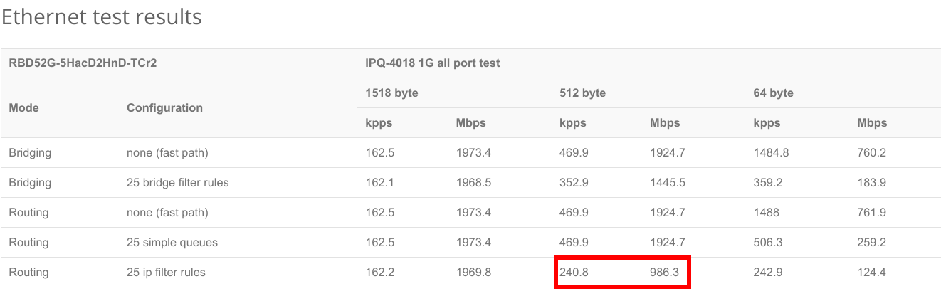

One general rule of thumb in sizing MikroTik’s is to use the test results that they list and look at the “512b/25 IP filter rules” cell and use those numbers as a basis for figuring out if it will pass the traffic you need:

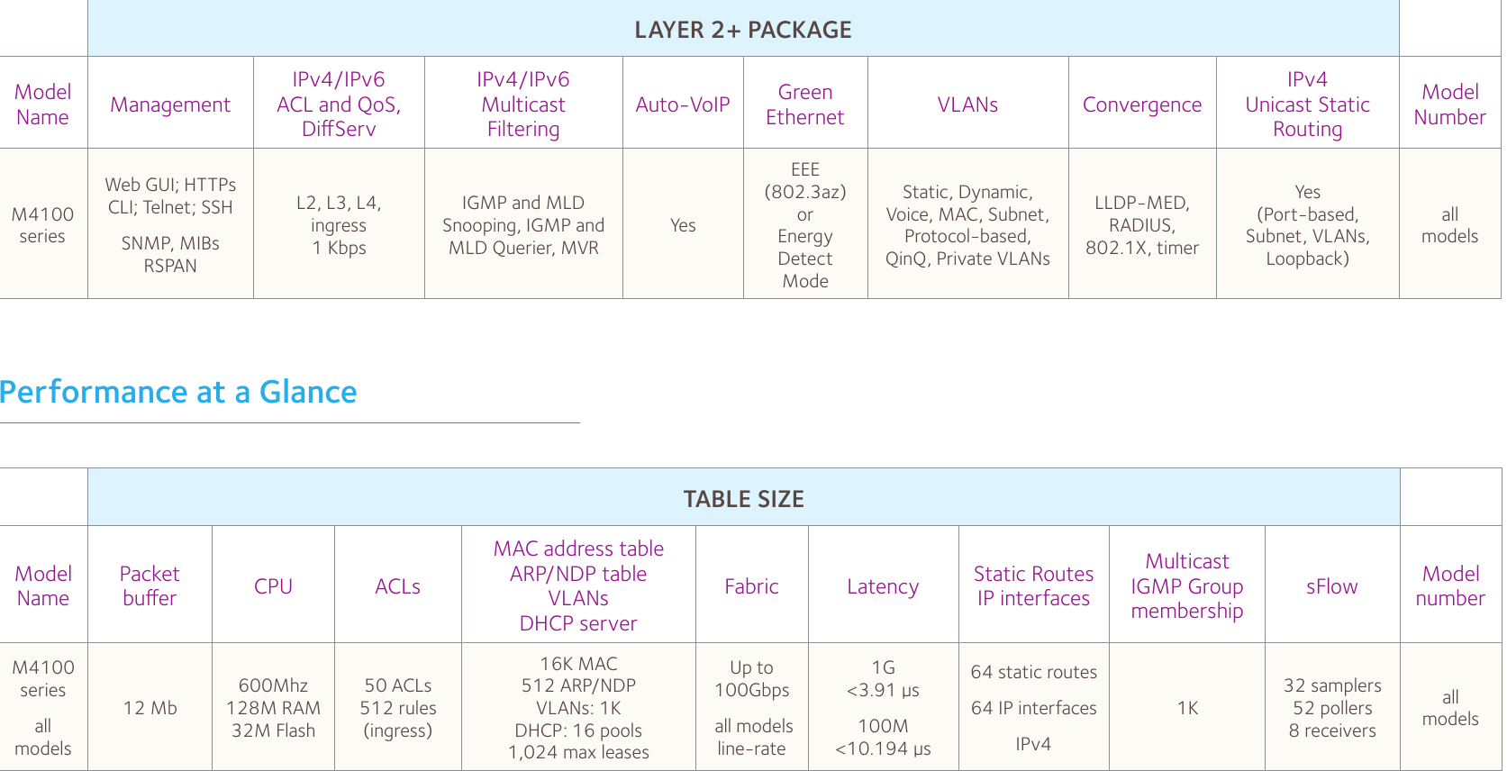

I’m not sure routing between VLANs on that switch would work for this setup, and I mean it about the “not sure” part. I don’t see anything in the manual about firewall capabilities, and I have this hunch you’d need them if any traffic is going between the guest VLAN and others and you might want a firewall between corporate and security too. I’d think an RB5009 or RB4011 would be more than able to handle the inter-VLAN routing for that setup assuming guests are basically just doing internet access and maybe hitting an internal web server and traffic between security and corporate is just people looking at video streams from cameras.
As far as I could see (again assuming I am looking at the right datasheet) the switch hardware supports basic routing and ACLs:
And yes I agree that a RB4011/5009 would handle that routing just fine.
