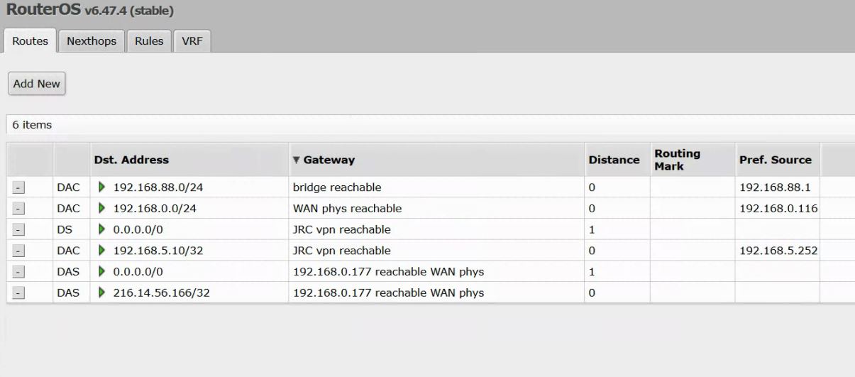

RouterBoard SSTP VPN Client connects and pings but does not route LAN to JRC VPN
I have made great progress with connecting to a Server 2016 SSTP VPN! I am very close. All config was done through WebFig.
These are the IP’s assigned by the Server 2016:
Routerboard Local IP 192.168.5.252 Pingable from Server 2016. Good! Also pingable from RouterBoard LAN ports and Terminal.
Remote IP 192.168.5.10 Pingable from RouterBoard TERMINAL but not LAN ports
adding default route makes no difference in these results. See attached picture with Default Routes enabled.
Routerboard LAN is 192.168.88.0/24
I want any RouterBoard lan requests only in the range of 192.168.5.0/24 to be forwarded through the JRC VPN.
Thanks, John

The default route via the VPN is inactive (DS not DAS), other than for ECMP you cannot have more than one active route to the same destination. Given you only wish to route some traffic via the VPN, remove this and add a static route of 192.168.5.0/24 with JRC vpn as the gateway.
You will either need a route back to your LAN subnet on the VPN server, or a masquerade NAT rule so your LAN traffic via the VPN appears to originate from the Mikrotik address (192.168.5.252 in this case) rather than the LAN subnet.

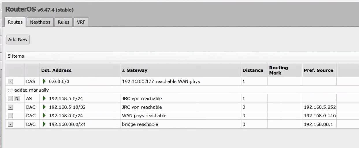

Thats progress! thanks TDW. Added route. see attached. The route added is one UNDER “ADDED MANUALLY”
The other route is created when the VPN connects and is not removable as it is dynamic. I tried.

You probably want the static route to be 192.168.5.0/24 via 192.168.5.10. The JRC vpn interface is dynamic and will disappear when it is down, causing your route to change to a next hop value of unknown, and it will not recover. Setting the next hop to an IP will simply disable the route when the tunnel is down, and will make the route active again when the tunnel is up.

No. With point-to-point interfaces you can specify the interface as a the gateway rather than an IP address. It correctly becomes disabled when the interface is down and active when the interface is up.

That has not been my experience in the past, but admittedly, I haven’t tried it in the last year or so.

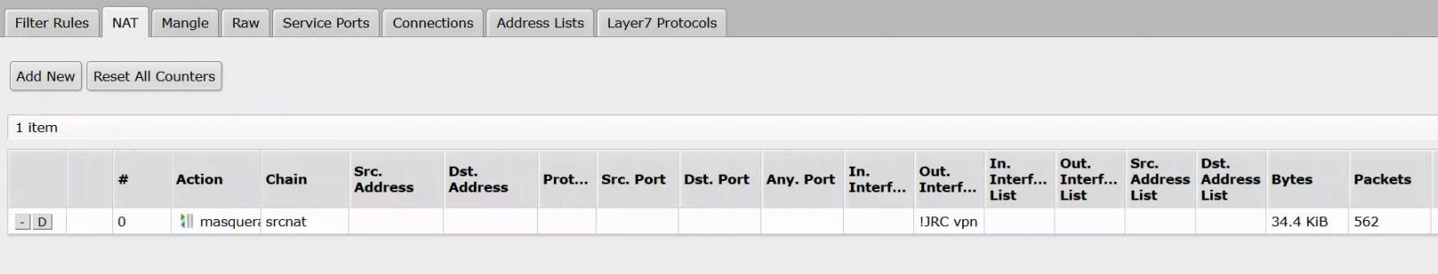

It isn’t the firewall. When using a VPN client on a Windows 10 machine the client traffic originates from the assigned VPN address so the VPN server knows where to return traffic to.
If the VPN server knows nothing of your 192.168.88.0/24 addresses traffic cannot be returned, hence the suggestion to use a masquerade NAT rule for traffic routed through the VPN interface so it appears to originate from the Mikrotik itself. The command-line rule would be
add action=masquerade chain=srcnat out-interface=“JRC vpn”

I added from webFig and it did not break anything, shows traffic but still no luck. Please see attached.

It is difficult to tell the name of the VPN interface from screen shots, apparently not “JRC vpn” from the error message you got. Entering a rule via the web interface is fine, and traffic appears to be hitting it as the packet/byte counters are non-zero, so something else isn’t quite right.

with source interface checkbox ticked in WebFig
i got this
add action=masquerade chain=srcnat out-interface=“!JRC vpn”
with it unticked
I guess I dont understand why ticking the box would do that
And it WORKS. thank you.
thanks, John
I can’t comment on how it appears in Webfig - in Winbox the equivalent control is either blank or “!”, not a check mark.
It doesn’t select whether or not to use an interface, it means ‘not’ so out-interface=“!JRC vpn” means traffic leaving by any interface other than JRC vpn - the reverse of what was required.
Thanks TDW. Not exactly intuitive that tick a check box means NOT but now I know.
