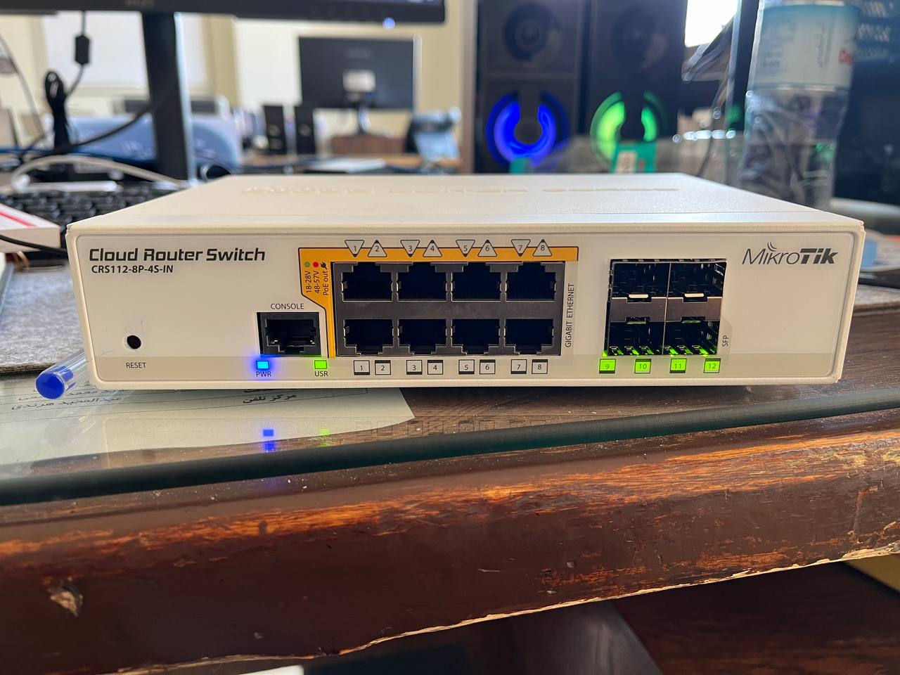

I bought a crs112-8g-4s-in router switch. After updating to version 7.10, the device crashed and it doesn’t turn on. It doesn’t even show up in winbox, and it can’t even be reinstalled on that operating system with net install.
What should I do?

I try to reset but not happening and try with switch between my computer and router and icant reinstall os
i attached device photo led never off and reset not work
Console output says it’s trying network boot … so if you connect to ether1 a PC with netinstall application set-up and running, it should boot from PC and enter netinstall procedure …
