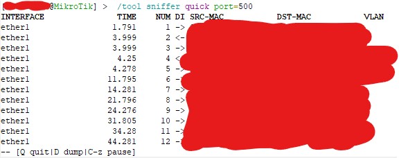

Okay I tried it but it shows nothing and then I thought okay what if I try with L2TP again and it shows this things so maybe this is telling us that port forwarding is correct and for some reasons IKEv2 is not initiating from client. is there anything I should’ve enabled in order for it to initiate? are Src Address & Dst Address are correctly set?
Also with the client (home) I can connect to another L2TP server without any problem (even before adding those two firewall rules) (don’t have the access to the server) so maybe both UDP port 500 and UDP port 4500 are forwarding correctly on the client side and we got a problem with server side or either the settings (Src Address & Dst Address) are wrong

L2TP client should send packets to port 500 on the server’s address; IKEv2 initiator should send packets to port 4500. Both should be shown by the sniffer.

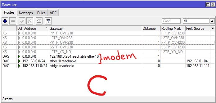

yeah it's 5.xxx.xxx.xxx but on Route List you can see it's also connected to a xx.xx.xx.xx which is a public IP as well

Nevertheless, in such a case, if you enable the IKEv2 peer and the identity associated to it on the client, you should see packets to arrive to 5.x.x.x:4500 if you run /tool sniffer quick port=4500. If you don’t, something is rotten somewhere outside the server side router.
It may take some time between retries, so sniff for at least two minutes before declaring it a fail.

right now when I run /tool sniffer quick port=4500 on both side I got only sends on client but nothing on server side. I’m worried maybe I should use the other public IP (the one server itself connected to) or different LAN IPs.
I used 192.168.11.111 (client) which is the router, is it correct or I should use 192.168.11.0 or 192.168.0.254 (modem)?

When you enable the peer & identity at the client and run the same /tool sniffer quick port=4500 on it, can you see the attempts there?
Yes
Okay… let’s do another thing then, set the port parameter on the /ip ipsec peer row at the client to 500, and sniff at both the server and the client with port=500 (still with IKEv2, not L2TP/IPsec). What’s the result?
