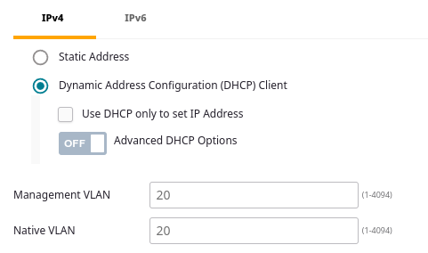

Plugged the AP back to the “ordinary” router, set it’s config Management and Native VLAN to 20.
Plugged the AP back to the RB2011iL.
The AP has still no connection to extremecloudiq. Gets no IP via DHCP.

I think I have 2 options,
A make the AP use VLAN 20 as native and management IF. (VLAN 20 is definitely getting to the AP, the associated SSID works fine)

Do not change native vlan from 1.

Yeah thank you, actually should have NOT messed with the native VLAN setting.
